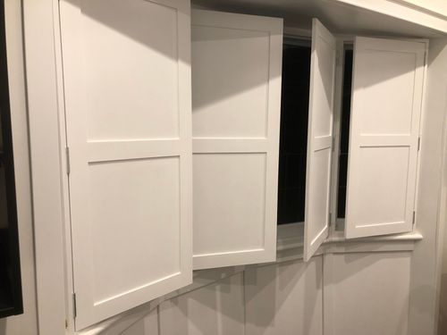

I was going to start with a simple one first, but I thought go with all at once, for three bedrooms. One of the bedrooms has a bay window, and being an old house, everything is out of square.
I started this project at the end of February 2023, now I'm getting close to the end. The bay window is nearly complete, just need to add handles, as yet not sure on style of handles to use.

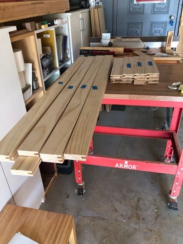

I do suggest that if anyone decides to make something similar, make sure you select straight timber for the shutters, to prevent and warped panels.

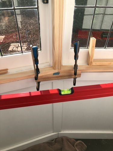

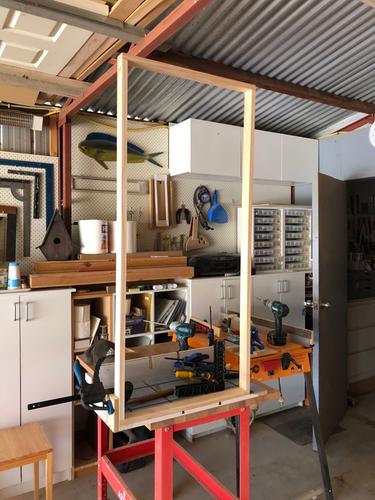

Measure you window size, allow for any out of square frame of window. then work out how much material is required, I bought mine from Bunnings, just make sure you select straight timber.

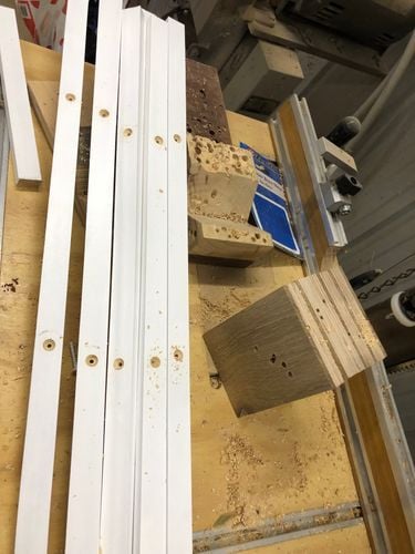

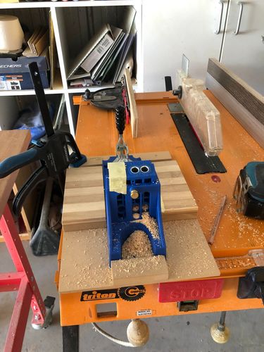

Make your frames for each window, cut, drill pocket holes, glue and screw together.

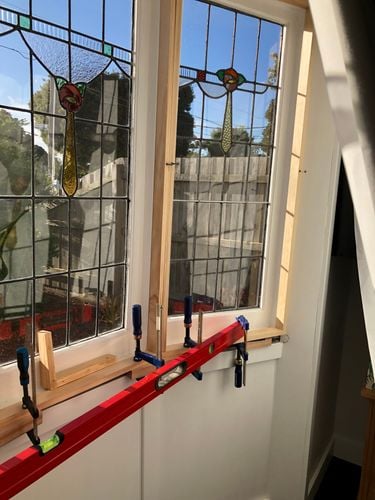

Once the framework glue has dried, check for fit in your windows.

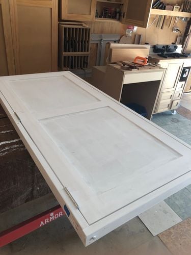

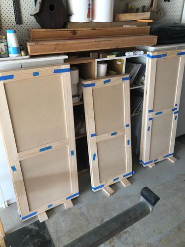

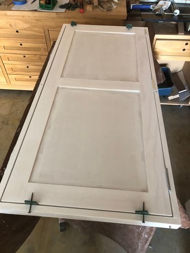

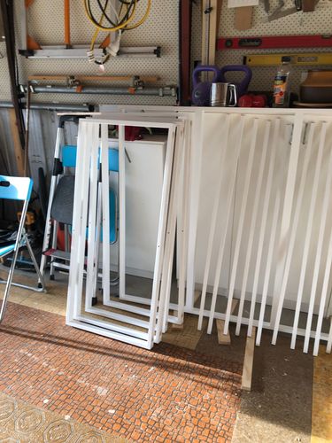

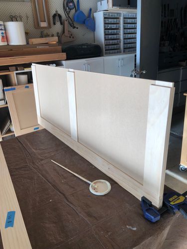

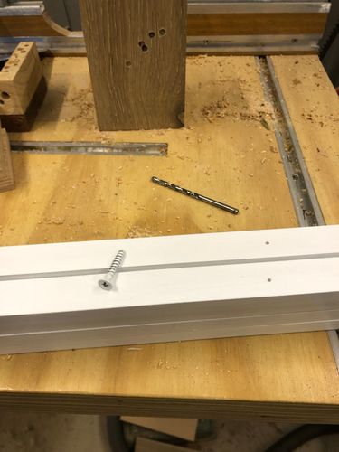

When you are happy with the fit, you can start making the shutter panels, cut all material to size , ready for routing the stile and rails, dry fit together, then cut the mdf insert to fit each shutter, when ready and checked, glue and clamp together.
Step 4

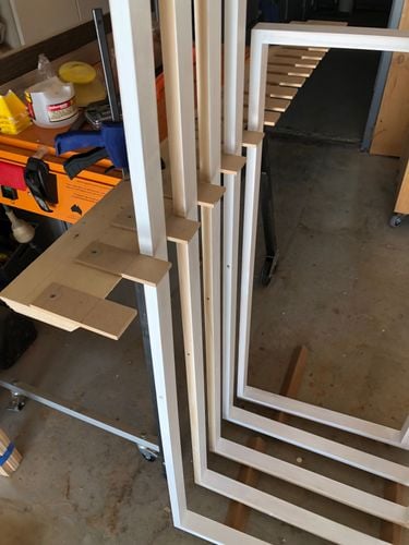

Sand and undercoat shutters ( 2 coats). When dried, install hinges, I used 3 hinges for each shutter.

Fit each panel to window, make sure its square and level.

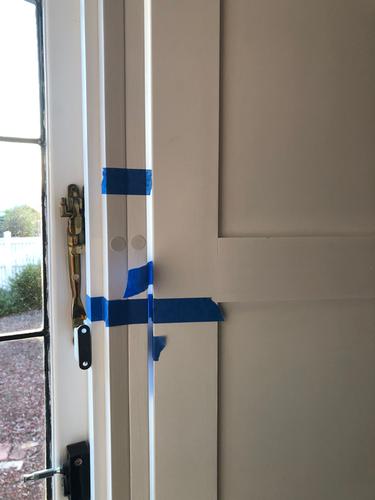

Cut, paint and install the door stops, 12mm x 20mm, I used white screws.
Step 8

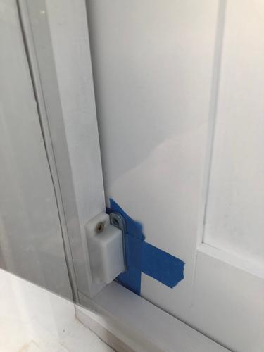

Install magnetic catches.
