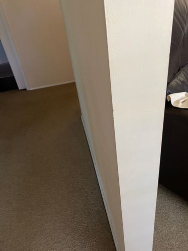

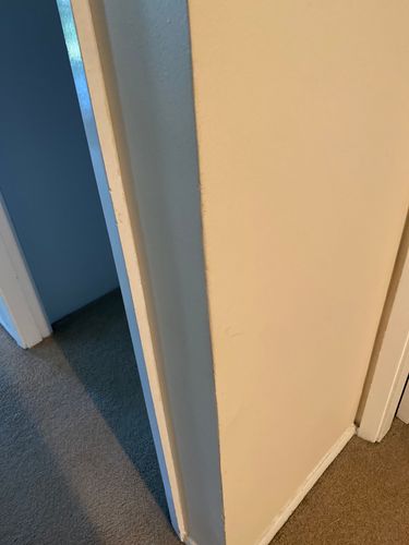

When I get to the end of a section of wall with no architrave (see photo), do I just finish it with a strip of beading to finish the edge?
Hi @Missskybird
If that's the condition for installation, I suggest instead using Porta 31 x 11mm 2.4m Moulding Pine Insert Mould Clear. It's the same size as your skirting and has a bit of style to it. When you get to the end, you have a choice of putting an 11mm plain standard moulding similar to your skirting board to create a picture frame look. I don't advise leaving it plain or open unless it's butting up against an end wall.
