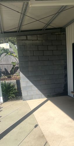

Hi, Can we use a standard tile to get a cobblestone look wall for an outdoor undercover wall?  (breaking each tile individually).

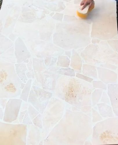

You can absolutely create that look on your wall. The style in your photos reads much closer to crazy paving than cobblestone. Cobblestone usually comes from uniform square or rectangular pieces with consistent spacing. Crazy paving relies on irregular fragments, which is exactly what you get when you break tiles by hand and fit them together like a jigsaw.
There is no single tile that produces that effect straight out of the box, so the process is always a manually created one. Breaking the tiles, dry laying them, adjusting shapes with a tile hammer or nibbler, then bedding and grouting them is how you achieve that natural, organic look.
Using indoor tiles on a vertical outdoor, undercover wall is generally fine. Walls do not experience the wear or slip requirements that floors do, and as long as you choose a tile that is not porous or that can be sealed properly, you will not run into issues. Travertine look tiles are a good example because most of them are porcelain and very low maintenance. A penetrating sealer will protect against weathering and staining, which is really all you need for an undercover area.
If you want to feel confident tackling it, have a read through a step-by-step guide on How to lay crazy paving. Although crazy paving is typically done on the ground, you can use the same principles and apply it to a wall. Also, take a look at a few examples from other members who have created similar features. Seeing how others planned the layout, managed grout spacing, and blended pieces together really helps visualise the process.

I suggest looking at the Davco 20kg Grey Ceramacrete Tile Adhesive as you'll be mounting it on a masonry wall. For grouting, I recommend the Dunlop 15kg Mid Grey Wide Joint Grout. My best advice is to make sure that the tile adhesive has fully cured before you begin your grouting. To prevent grout staining on the surface of the tile, I suggest having a second set of hands cleaning the tile surface as you grout over it. IN this manner you won't have to worry about stray bits of grout sticking to the surface of the tile.
