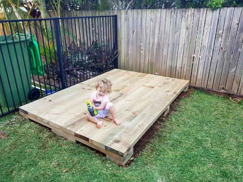

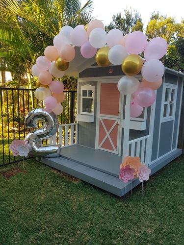

So we ended up totally changing ideas. We bailed on trying to join 2 cheaper cubbies & just purchased a larger pre-fabbed one that had it's own floor. So now that the base wasn't really going to be seen, we no longer cared about the "decking" look.
We ended up digging out the grass, but leaving the ground with a slight fall for drainage/run-off. And then we built a raft-type structure with the treated pine sleepers, and used offcuts to make 200mm x 200mm & 400mm x 200mm "feet" blocks to raise it up a bit more. We then cladded all the edges with treated pine fence pailings & painted the whole lot with 2 x undercoat & 2 x Weathershield (bcos we had painted the cubby anyway).
It's a very sturdy/heavy base & we had a substantial amount of rain in May without any sinking/movement so far. We are on clay though, which may/may not make a difference? It's held up to both my partner & I and our toddler playing in the cubby, plus the cubby itself obviously (so 200kg+). We're only hoping to get about 3-5yrs out of it anyway. Here's some pics I took along the way. Happy building!
