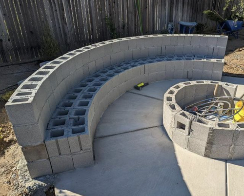

About to start building a bench seat like the one above in our courtyard. We currently have a slab laid and my question is, do we need to put down a dpc between the slab and the first course of blocks. The slab drains well with a nice slope to it and also have a channel drain that will sit in front of the bench.
Cheers.

Hi @bow2021
If you have very good drainage and the area dries quickly, I don't think it will be necessary to install DPC between the slab and the first course of blocks.

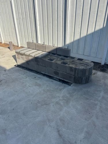

started putting besser block caps on the block seating I’m building but someone has said to me that they will probably come loose down the line even after render it all as the weight of people will loosen them. Is that the case? Should I remove the ones I’ve added and just fill all the blocks and render over that? I’ve only filled every other block so far and the back row with the back rest I will fill completely. is it fine to just continue using the caps? Kind of liked the little bit more height they added as well.
Thank you.
Hi @bow2021,
As long as there is a good bed of mortar beneath the capping blocks, then they shouldn't move. If they were overhanging the sides or on an uneven base, I would be more concerned about them shifting under weight, but they look solid to me.
Ultimately, getting rid of them would remove the possibility altogether, but it would reduce the height of the seat below what you originally planned for.
Personally, I don't think it is an issue. Unless you were particularly concerned, and you could deal with the reduction in height, I don't think there is anything to worry about.
Allow me to tag our experienced members @Dave-1, @Nailbag and @AlanM52 for their thoughts.
Much appreciated everyone for your response, good to hear I’m on the right track.
Afternoon @bow2021
Im also jumping on the waggon with leaving the caps in place
Mostly because i think it will look better and if some come loose "down the track" then its just a repair job really. I have got caps on my bessa blcok walls from before I moved in and they are still going strng even tho its the most shoddely built retaining wall I know of lol
