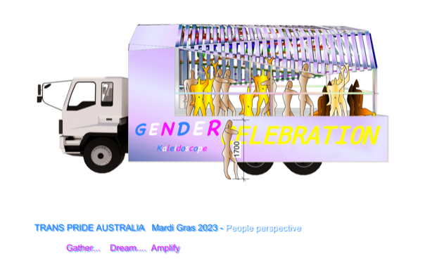

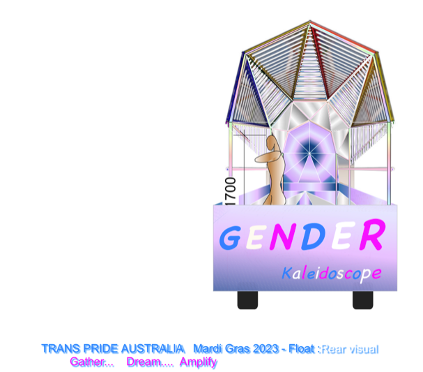

Hi , Im wanting to construct a float for Mardi Gras 2023, and wanting to use the pallets as the base, so we can construct in 3 sections and pallet onto a 7.5m flat bed of the truck.
Has any one done this before or perhaps would this work for those of you with experience and knowledge of pallets?
Thxz
Screen Shot 2022-12-22 at 5.27.58 pm.pngScreen Shot 2022-12-22 at 5.28.14 pm.png

Pallets do come in different qualities, and you'll typically find softwood Pine pallets readily available. To cover a 7m area approximately 2m wide, you'll need around 12 pallets. The best way to source them would be by contacting or dropping into your local Bunnings stores and picking up what's available. You'll want to start getting the pallets now, as if you want all uniform thicknesses, you'll have to search for them. There are no weight specifications on a pallet, but they'll hold significant weight and should be suitable for your project. Just make sure they are strapped down well to the truck bed.
Below I've constructed some renders to assist with your build plans. I'd recommend making the frame in three separate sections as even with a team of helpers, you won't be able to lift the pre-made structure onto the truck in one piece, and I certainly wouldn't recommend you use a forklift. To join the four pallets used per section, I'd recommend bolting them together and using support timbers between them. Hopefully, the renders help with how this will work. The only suggestion I'd like to make to your incredible design is roof access so someone can stand on a platform and have their upper torso above roof height. If you do this at the truck cab end, it shouldn't take up too much floor space, and a DJ would fit perfectly under the platform. I don't know about you, but being able to wave to the crowd out the float's roof would be a real treat.

These were my rough ideas before I thought of the recycled Pallet, as in base construction. Also the truck bed size has changed to 7500 x 2450mm, also include the first float I built for 2020 MGScreen Shot 2022-12-23 at 3.03.24 pm.pngScreen Shot 2022-12-23 at 3.03.40 pm.pngScreen Shot 2022-12-23 at 3.03.53 pm.pngScreen Shot 2022-12-23 at 3.02.49 pm.pngScreen Shot 2022-12-22 at 5.18.54 pm.pngScreen Shot 2022-12-23 at 3.09.43 pm.png
