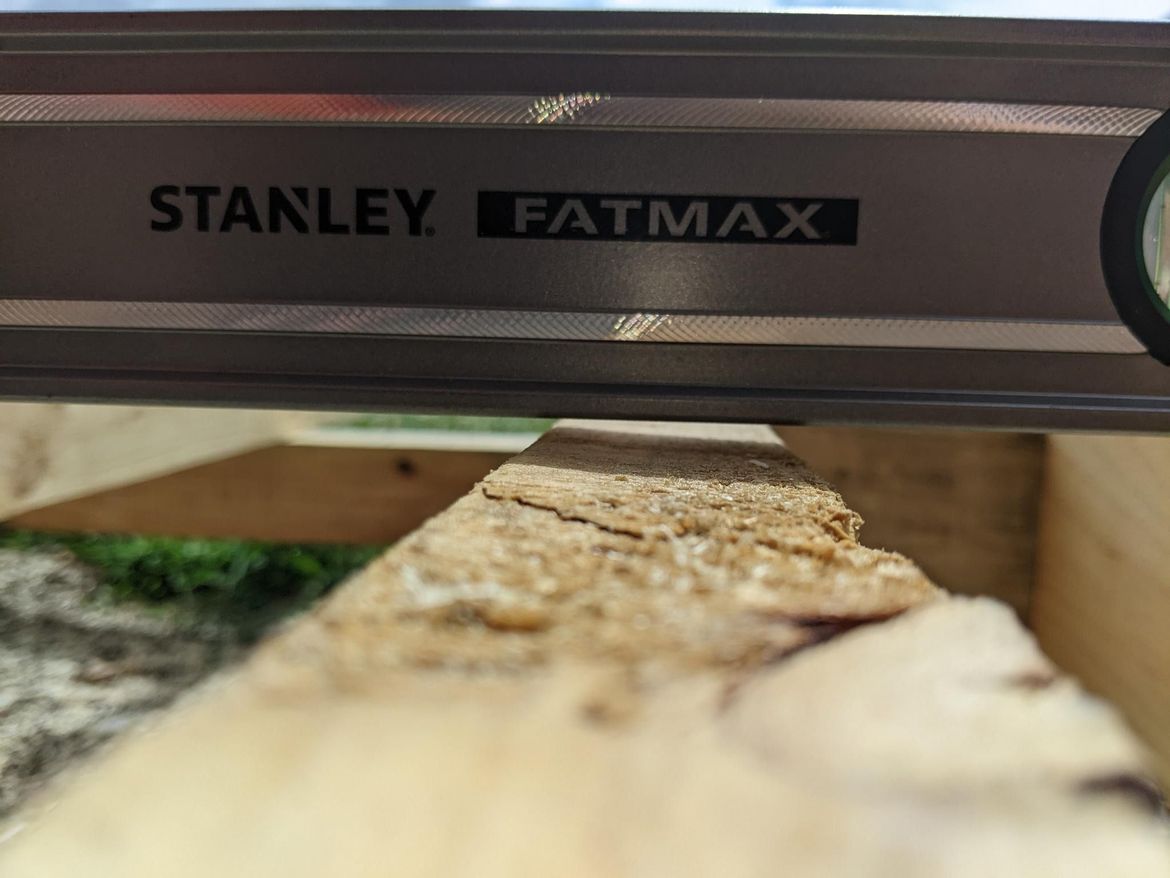

So, I've now planed all the joists where needed. I can run my level across the joists with ease and I've removed any high spots so the level doesn't see-saw. Aside from the fact that the level will catch itself on the edge of a joist, it's probably less than 0.5mm, so nothing to worry about. All in all, it's pretty flat.
Except for 1. The 3rd last joist (which you can probably tell in the picture, hasn't really been touched by the plane) sits up to 5mm low in some spots.
Yet, 400mm further down, it's fine.
I had a few of these laying about which I could use to nudge the joist up by a couple of mm to close the gap for any section of joist that is over the concrete. However, the span that isn't over the concrete might be a little tricker. So, what are my options?
Can I use shims under each decking board on that joist to eliminate the gap?
Re: Deck options
Hi @IronStan001
Using plastic shims would be the easy option, you could make your own timber shims but that would take a while and they would shrink in time, whereas the plastic shims would retain their shape.
