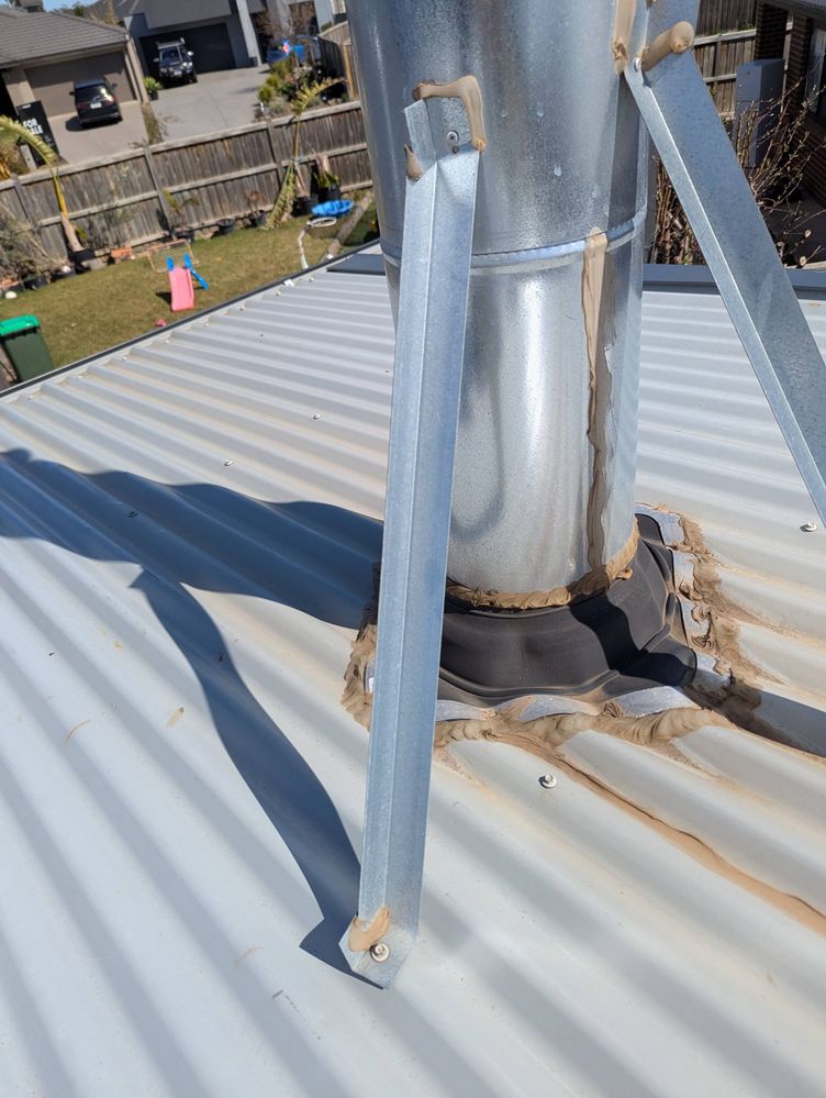

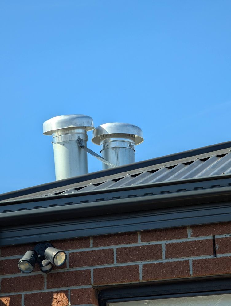

Got these double flue's installed but I am not happy with how one is on a slight angle
it was worse than this before I had to put a piece of flat bar and hold it
But as you can see the mushroom caps are hititng each other so I cant get them as straight as possible
Called the plumber and apparently all his tools have been stolen just the day after he installed my flues so his not coming back to fix
But I feel it should be pretty easy "IF" I can get the right parts
These flue's suit a 200mm duct so I need like an extension steel pipe to go over the top or inside the pipe. So then I can fit raise the height just enough for the musroom cap to sit higer then the right hand one. This should allow me to make them straigh

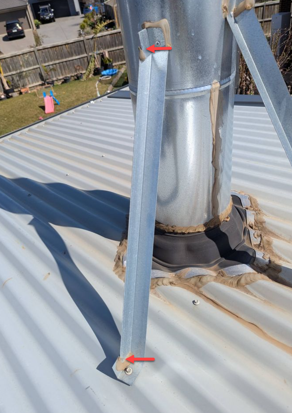

I also would prefer using a brace like my fire place which would be much easier to bend to the right angle
Where would I get these two parts do bunnings sell them. Looks like just angled steel but very thin. Need something as thin so I can bend to shape easy while I am on the roof.

The closest thing I can find is this Scandia 8" x 1m Galvanised Steel Casing Length, which can be special-ordered. It appears to be much the same as the product you linked to, and at 8 inches in diameter, it should be 200mm like your duct.
The braces look like they are just some bent Australian Handyman Supplies 40 x 40 x 1.15mm x 2.4m Galvanised Pressed Angle. You'd just have to make a relief cut in one of the legs of the angle in order to bend it to the correct angle to act as a brace.

Thanks for the reply @JacobZ Id prefer getting the metrix type I linked which I also have to order so its exactly the same size. As it as to be a tight fit. Ita also half the price
Ill grab those angle brackets. Just hope they are easy enough to bend with pliers while I am up on the roof after the releif cut

You won't have any issues bending that angle. After the relief cut, you'll easily be able to bend it by hand. Just bring a pair of aviation snips with you so you can cut it to length and make your relief cut. Also, wear some gloves as it can be a bit sharp once cut.
After you've screwed it to the roof and the flue, I'd also recommend putting a screw through the overlap where the angle has been bent, as this will lock the angle in place so it can no longer bend.
