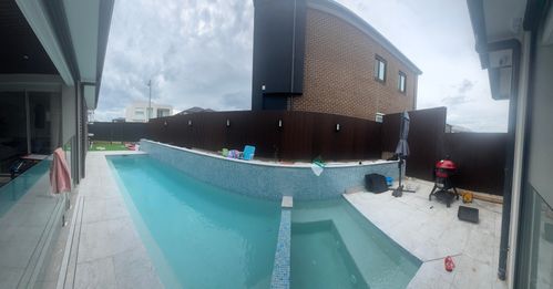

i have received retractable wave sail shed and I am planning to install 4 aluminum post to Marble stone floor of 30 mm thickness.
the length of the retractable runner shed is 16 meter , width is 2.4 meter.
how can i install these posts to be fixed safely to ground?
if need to cut the marble stone , how we can do it?
i do appreciate your reply

3- the base underneath the marble is Concrete  i will need to install 2 posts in the marble tile.
the other two posts will be installed in the ground which artificial grass and underneath is compact soil.
4- the post does not matter either in square or round shape.
the length between each both sides of the pool is 16 meter
please let me know if you need more clarification
