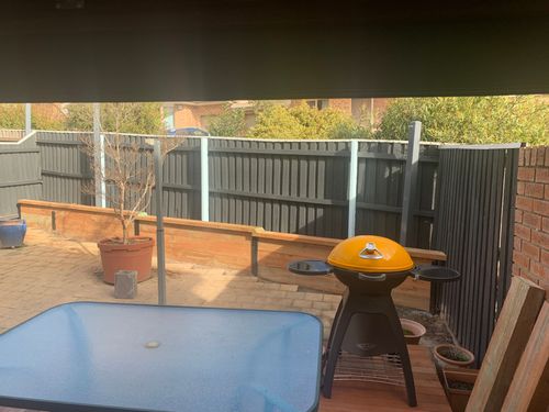

OK, here it is in all its glory.. Thanks to everyone who replied with tips and advice. And yes, its level!

Thank you for sharing your retaining wall project. It looks fantastic! What stain did you use to colour it? Did it take very long to build? I'm sure our members would love to hear the details of your build.

It was a pretty straight forward build in the end. I did it over a few weekends, someone with experience would be able to do it over a single weekend I reckon. The colour is the colour of the Sienna Treated Pine Sleeper I obtained from Bunnings. The colour is growing on me but I think I'll apply some decking oil to darken the colour a bit.
