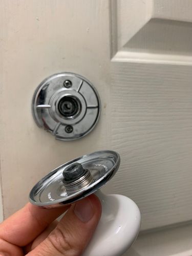

My daughter is locked out of her bathroom. There's no one on there and she can't get in through the window. Any suggestions? I have a video but no photos and can't seem to find how to upload a video on here. It's a round knob like the one in the photo my son sent from his house. But the knob in question is intact.
Hello @Kightleys
You are actually halfway there; I suggest getting your Philips screwdriver and removing the mounting screws on the faceplate on the door. Once the screws are out you should be able to pull out the face plate and push the door knob assembly out with your screwdriver. From there you'll be able to see the latch and locking mechanism, you should in theory be able to unlock the latch and turn it using a flathead screwdriver.
I've placed an image below to give you a better idea of how the door knob is assembled.
Please keep us updated with your progress, we look forward to seeing the door unlocked.
