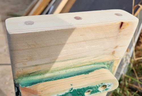

Hi all, well Part A is done and drying. When I cut back to reach the top of the white ants damage I found a small dimple in that face. That was the extent of their habitation so I know I have gotten it all. Whew!

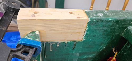

A neighbour gave me a nice length of 100 x 50mm pine so I cut that back to slightly oversize, Bogged up the little bits of tunnels that were left with Andrews Water Putty and left it to dry. Later I cleaned off the area, put on a good coating of Tech Grip 125g SilkaBond Tech Grip, clamped and screwed, and left it overnight.
This morning this is what it looks like. Once I clean this off I can rinse and repeat for the last part of the leg. That should see me back to battleship condition ready for finishing off and painting. Whew!
This is the first time I have used Tech Grip and I am pleased with it. Easy to apply and so far seems to have done a good job. By the look of the overflow I was perhaps too liberal in the application. That will sand back so not worried. All good learning.
This morning I checked the set of the glue. I can put my fingernail into the surface. I might let it set a bit before bringing out the sanders. So time to mix up a little Agnews and fill in the screw holes, by the time it dries the rest should be ready for sanding.

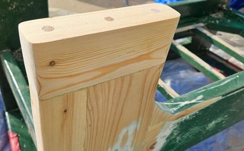

OK, second bit fitted and glued. Now to wait till that dries before I can sand it back to fit the profile.
I have also started to sand down the area of the new work. It is looking good even though I am only on 120 grit for this start of the process.
I fixed 3 dowels into the screw holes so I have solid wood where the leg hits the floor. The next step is to cut them off flush and sand the whole part. I might fix some industrial carpet or similar so that my legs don't scratch floor surfaces.

That is some serioulsy nice work! You wont be able to notice that the chair has been at war ![]()

I need to update you on the last actions that I took on the legs.
I levelled off the leg base by cutting back all the dowells and sanded it all smooth.
Now I have to finish sanding back the old surfaces and give a coat of undercoat. Then start with the green paint.
