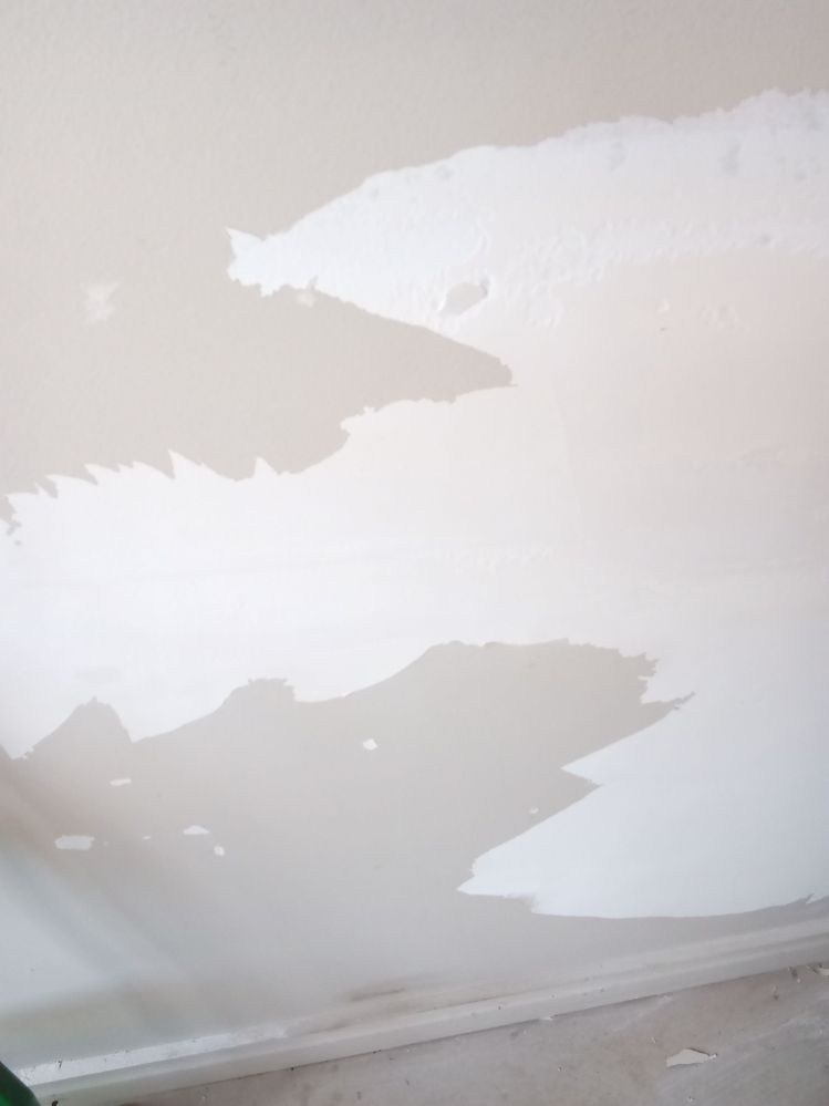

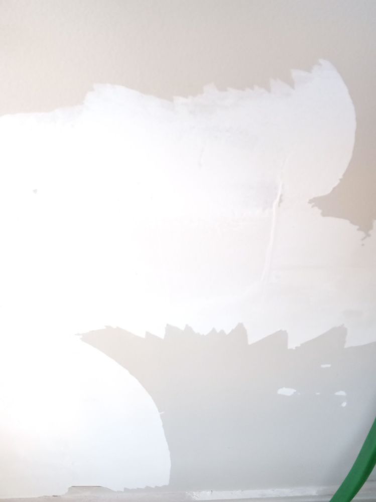

Thank you very much for your reply.  I have uploaded a couple of pics.  It doesn't sound that daunting after your advice.

Hi @SherylM,
Thank you for the photos. Yes, that definitely looks like paint applied without primer.
Follow the advice above, it will see you through.
