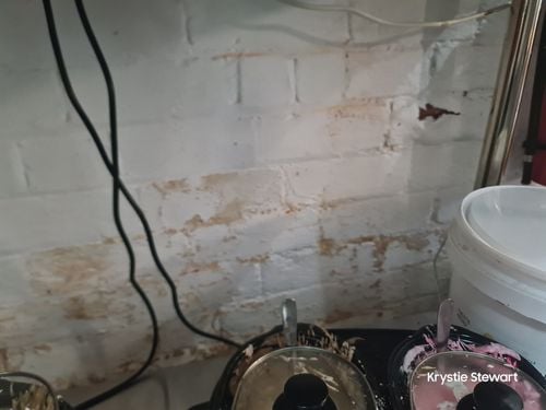

      I have rising damp in quiet a few walls in my business, I have tried the additives you put in paint n it hasn't worked I was just wondering if there was something I could do to fix the problem. As I can not afford to have my shop shut, as you can see in the pictures it's getting to the point it's bubbling the paint.

It is difficult to tell where the water is coming from inside your wall. It could be a leaking pipe or natural moisture draining into your brick wall from the soil on the other side. Technically the proper way to repair it is to seal it from the other side to prevent anything from flowing into the brick.
However, if access to the other side is not possible, I can only suggest using Dunlop 4L Damp-Proof Waterproofing. It is an acrylic brush-on membrane, Dunlop Damp-Proof Waterproofing will prevent rising damp, efflorescence and will resist negative hydrostatic pressure.
I suggest scraping all the paint off the brick wall before using the sealer.
