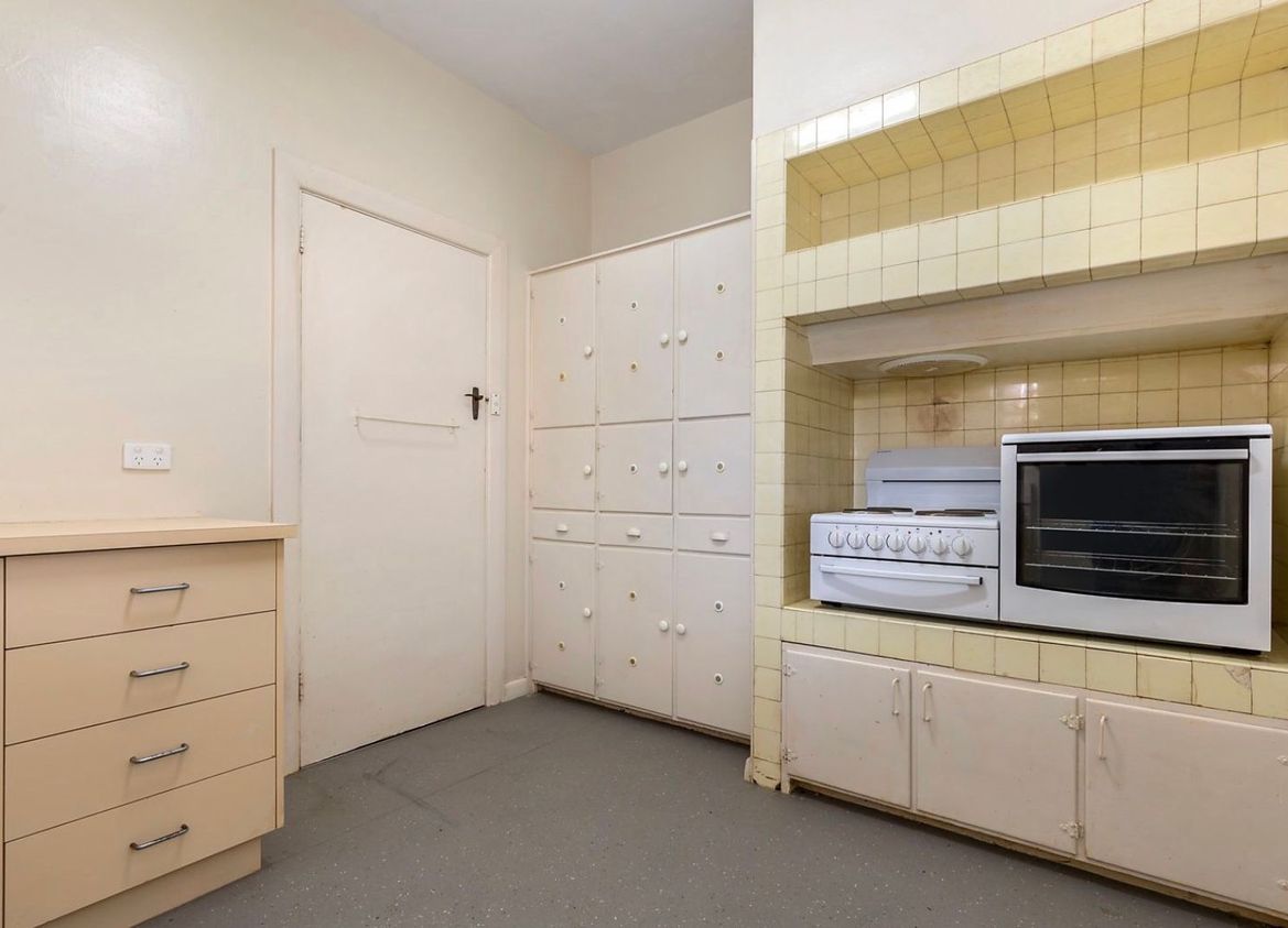

Other half of the kitchen. The entry door is to the left.Other half of the kitchen. The entry door is to the left.

Firstly, great apartment @magen_ I'm jealous! Your ideas are spot on. Love the idea of refining the entry to the study and closing the access to the bedroom.
How much further you can take the renovation will depend on what the property will be worth in the end, and what budget you chose to allocate to the project. Also, an engineer should be the first person you call in to ask specific questions about how many internal walls you will be allowed to remove (if any). Removing doors won't be an issue, but opening up walls will. And you will have to work in with strata management. They can be a bit of a pain, but find out what they require first e.g. where they want you to have the skip bin delivered etc., and also if they have any restrictions on the type of flooring you are allowed to use.
If it were me....assuming the TV will be on the same wall as the fireplace, I'd love to see the wall between the lounge and the kitchen opened up as much as possible, allowing you to add an island bench to the kitchen. Opening up that space would give it a modern feel. Spend money on taller skirting boards, which will create opulence and a nod to the era. The cornices are great!
Have fun with the cosmetic changes, especially the tile choice. Enjoy this project. I love older units with entry doors like yours, as they are so pleasant and breezy to live in.

Hi @magen_ - what a beautiful space, I find Art Deco really kind of funky. The advice I’d offer (having removed walls from a couple of places) is get a good building designer/engineer/Architect. It is only possible to remove load bearing walls, by putting in a beam to support the load. Looks like you’re on the ground floor, so it’s likely to be difficult and expensive - but not impossible.

It's late but I managed to finish one side of your kitchen. If I have time I will upload some more tomorrow.
My suggestion for the cooking side.My suggestion for the cooking side.
