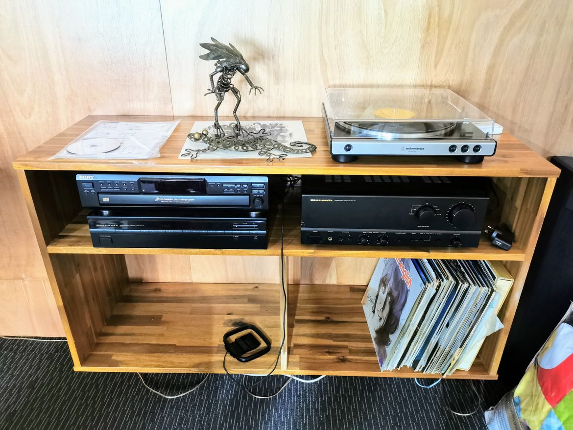

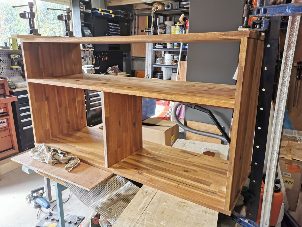

Hi, Just thought i would put up a couple of photo's of a simple wall mounted entertainment unit i built using laminated panels from Bunnings.
I used simple biscuits joints to join it all together then a few coats of a clear finish.
Apologies for teh album cover if anyone if offended 🙂
Still some tyding up to do dut i think it will serve its purpose
That's a fantastic project @wooshka, simple and elegant. What did you use for legs, or is it attached to the wall?
Well done and many thanks for sharing.
@MitchellMc I attached it to the wall with a simple piece of quad underneath the bottom shelf , the second shelf has a vertical panel you can only just see in the first photo so i could screw into the wall studs, i didn't want legs underneath, trying to keep it clean lines
