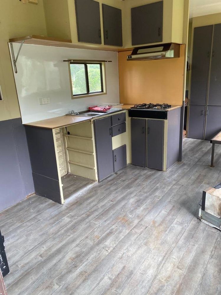

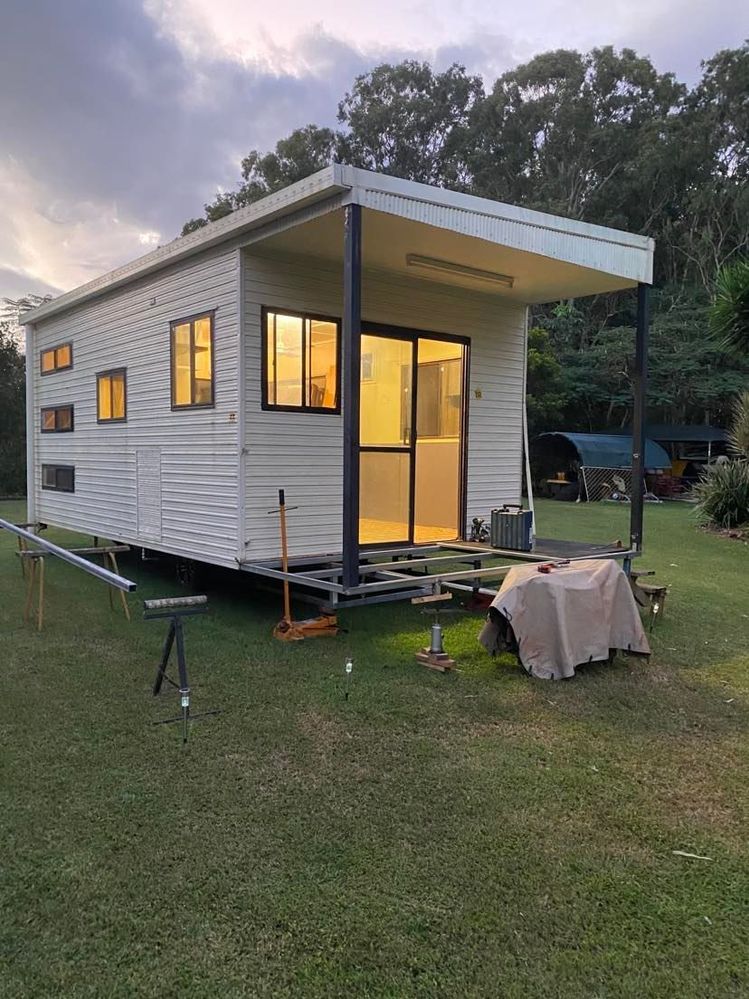

Hi, I have bought this little cabin and my dad and I are renovating and turning it into a tiny home. We are pretty much stripping the inside including flooring and wall panels and will enclose the patio and turn it into the bathroom. The floor plan will be different, with a window being changed into a door for access
I am on a budget (cheap cheap) and would like some advice on options for the following:
- wet area sub-flooring (considering Particleboard Green Tongue)
- wet area walls (considering Plywood Hardwood Marine AA Grade...not sure if you can tile over the top though for shower/vanity splashback etc.)
- regular sub-flooring (considering Particleboard Yellow Tongue)
- internal walls (would love VJ, but something cheaper would be good, another option was Plywood Hardwood Marine AA Grade)
- exterior cladding (plan on painting the existing exterior Colourbond Ironstone, so a contrast maybe with a vertical line would be good. Am considering Custom Orb or Mini Orb)
- other cheaper options to tiling in the bathroom
- we are also thinking it might be easier to leave the sliding glass door where it is, meaning it would be the bathroom door. If we do this, we would obviously need to make it private. (considering frosted glass spray or frosted window film)

Hi @Bek79, this sounds like a fascinating project (I have subscribed to the conversation to read how it unfolds). My thoughts at this stage are around the fact that one drawcard for tiny houses is that they can often be moved when/if circumstances change. If you add ceramic tiles to walls or floors, you will have cracking issues if you need to move it. I suggest that you consider tile-like surfaces that are flexible and water proof if there is any chance of wanting or needing to shift the house in future. Looking forward to seeing how you develop it.
