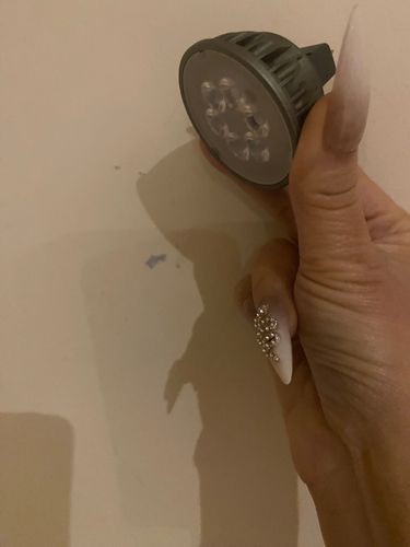

I'm planning to replace my old non-dimmable LED downlights in my living room with dimmable LED downlights. My existing LED downlights have the following details.
MR 16 6.5W 600LM 12V 3000k
Brand: Onsemi EcoMatters- 90E2
Dimensions: 48mm x 58mm x 5mm
Please find attached photos above for reference.
I also need to buy the same type of non-dimmable LED downlights for my bedroom and bathroom.
What kind of dimmable and non-dimmable LED downlights and matching dimmable switches would you recommend?

You will need a licensed electrician to help you replace the non-dimmable downlights and install a dimmer switch, so it is best to confirm the compatibility of the parts, not only with each other, but with the wiring in your home, with your electrician before purchase.
For this part of the project, assuming your electrician deems them suitable, you could use these Arlec 9W 92mm Tri-Colour Dimmable LED Downlights, which offer three different options for the spectrum of light produced.
You should also be able to use this DETA 200W Universal Electronic Dimmer With X6 Series Wall Switch, but once again, you should confirm compatibility with your electrician.
With the non-dimmable downlights, are you looking to just replace the bulbs? Or are you looking to replace the whole downlight altogether?
If you are just replacing the bulbs, then these Osram MR16 12V 60D LED 500lm Warm White 5.5W Downlight Globes would be extremely close.
If you are looking to replace the downlights, you could use any tri-colour downlight set to the warm white setting (3000k).
