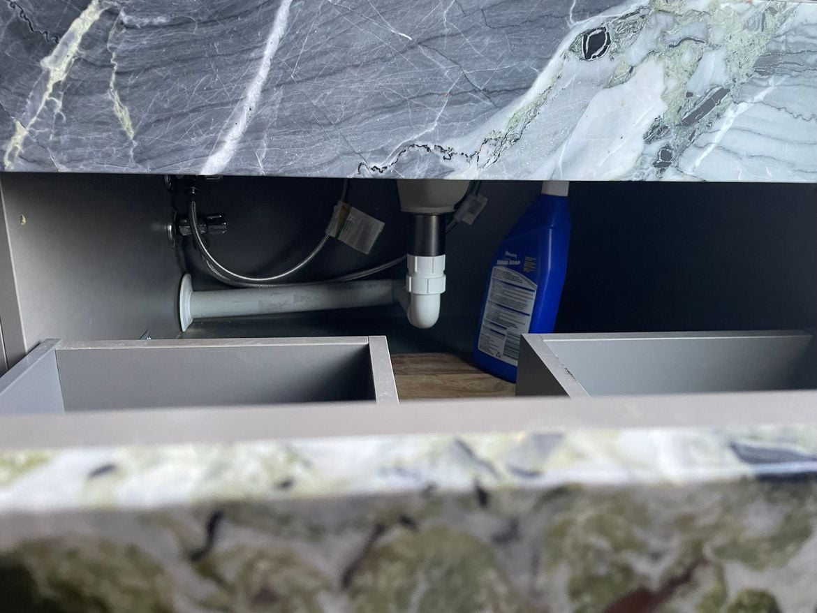

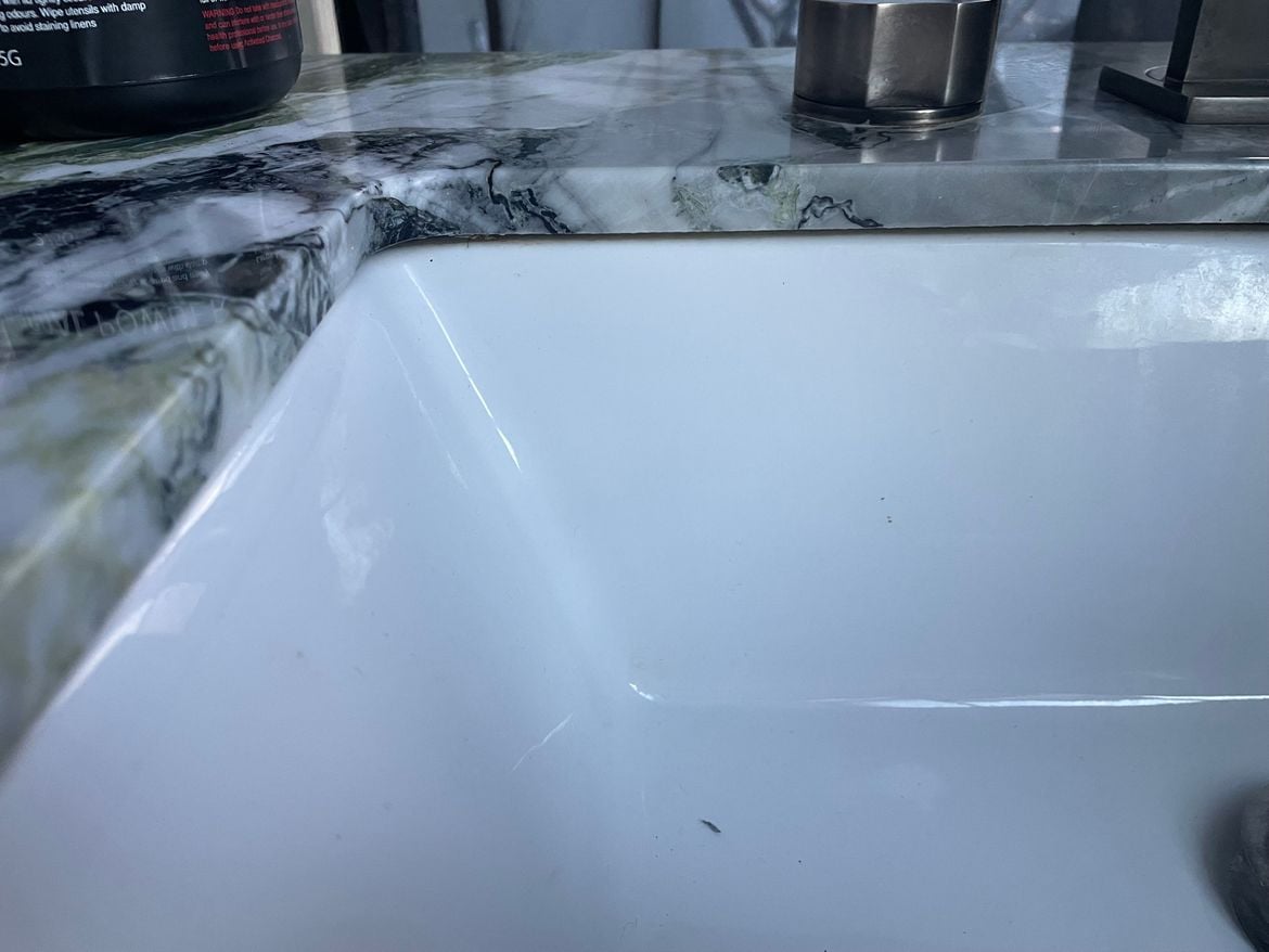

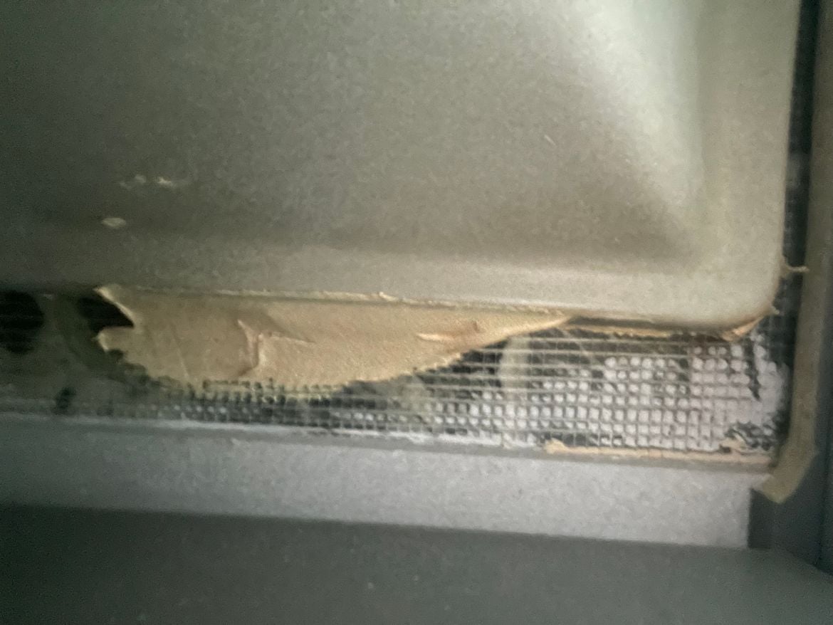

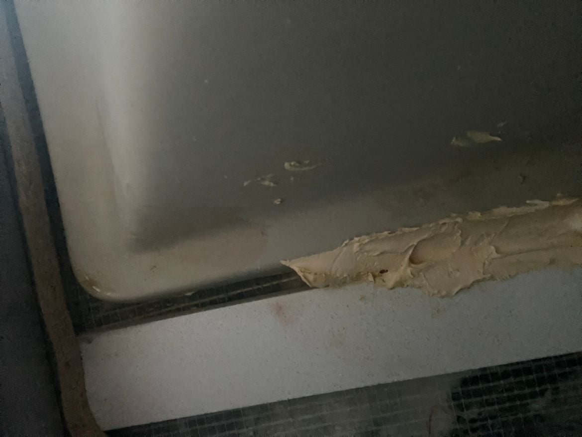

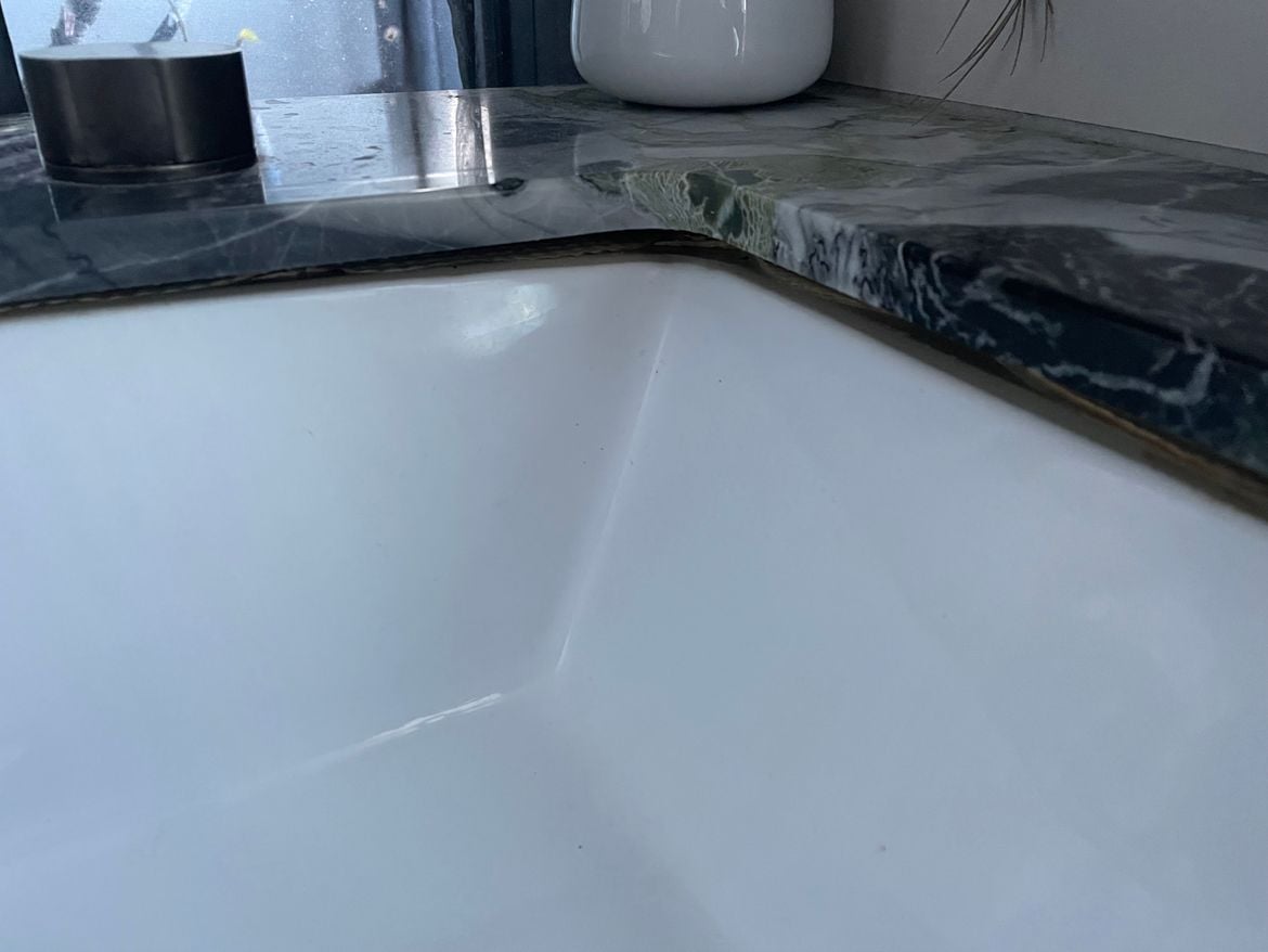

Hi, we have a defective ceramic basin dropped from the stone benchtop wihtin the drawer. The building is just 2.5 years old.
Could we re-glue ourselves, if so, what type of glue or silicon do we need to purchase? Do we need the kind of car jack stand things to make the basin in correct position until glue works?
Or if we'd better ask a professional trade person, would he/ she be a stone maison or a plumber??
Please advise.
The right hand side is dropping and I located the bottle underneath to prevent more damages.

I suggest engaging the services of a builder who specializes in kitchen and bathroom renovations. They will have the knowledge and experience to re-attach your basin to your stone top. Yes, an adhesive will be used to rejoin the portions together, but the builder will use non-destructive methods to compress the parts together.
It's possible that they might use ratchet straps or compression clamps in combination with timber spacers. It all depends on what the situation calls for, and the builder will make that determination once they've examined the damage.
In the meantime, I suggest informing the rest of the household not to use the basin as it could further aggravate the damage.
