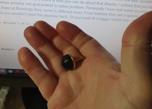

I have managed to cure noisy, screeching taps with this kind of washer...
Or maybe you've already tried them?

Hi Noyade, thanks for your advice.   No I haven't seen this washer before.  Would it fit any independent tap? And at Bunnings? What brand is that?
Thanks.
Re: noisy hot water tap on vanity
Hi @MYC,
They will fit any older style internal tap that has a tap valve, and they are called dome valves. That one specifically appears to be the Kinetic 12mm Brass Dome Tap Valve.
Some other valves you might like to try are the HydroSeal Anti-Hammer O-Ring Tap Valves, Kinetic 12mm Anti Hammer Tap Valve and Kinetic 12mm PVC Anti-Hammer Tap Valve. These are mainly designed to assist with water hammer but could improve your situation.
