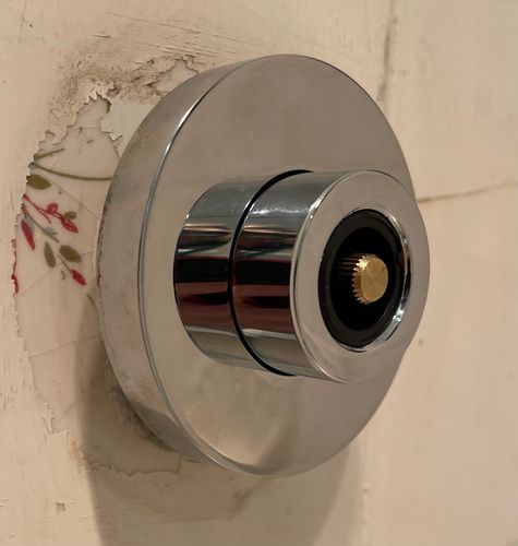

The first time I tried to install it the sleeve screwed too far in, leaving the locknut exposed and the flange barely attached to the sleeve (see below)

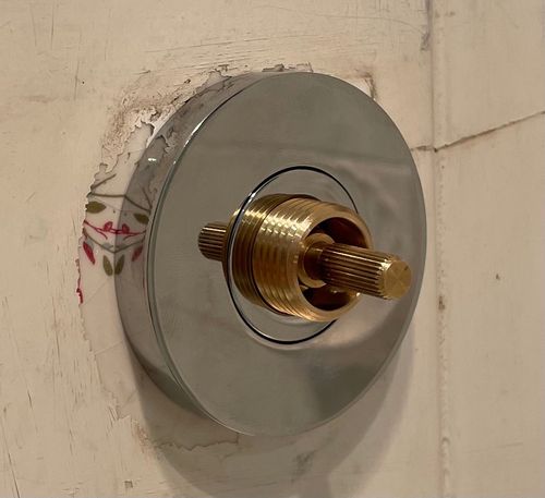

The instructions said that if this was an issue spindle extenders could be purchased however I could only find one size and that was too long so the flange wouldn’t sit flush with the wall (see below)
The instructions then said that this issue could be resolved with flange extenders. However if I purchase those and leave it as it is above then the lever handle won’t attach to the spindle properly.

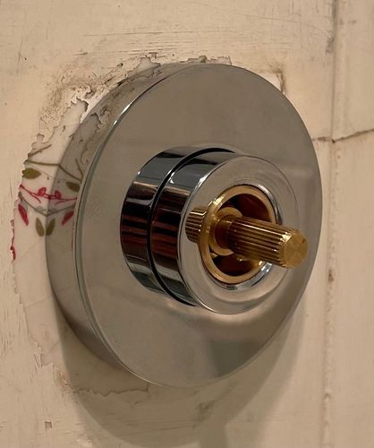

3. Screw the sleeve in just enough so it’s flush with the end of the locknut (see below) However this means it will be quite loose which I didn’t think was a good thing 😅

Thank you for sharing your question about the flange on your spindle. If you purchased the Kinetic 15mm PVC Spindle Bonnet Extender - 2 Pack it is possible to cut down the plastic bottom so that you can keep going lower on the spindle. This in turn will allow you to lower the flange piece that is too high.
In regards to adding washers to the locking nut, I don't recommend it as it will interfere with locking motion of the nut.
