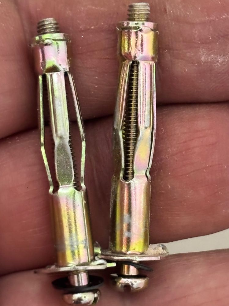

I uses Ramset M4 x 8mm Hollow Wall Anchor
https://www.bunnings.com.au/ramset-m4-x-8mm-hollow-wall-anchor-10-pack_p2260115?store=7379&gad_sourc...

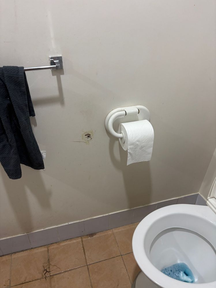

At a bathroom to install new a toilet roll holder,,,,,I bought the one in the link above assuming the thickness of plasterboard is 13mm
I followed the installation instruction on the box (attached) it says :
1- Drill an 8mm diameter hole into the substrate
2-Tap the anchor into the hole until it is flush with the surface of the substrate
3-,,,,,,etc

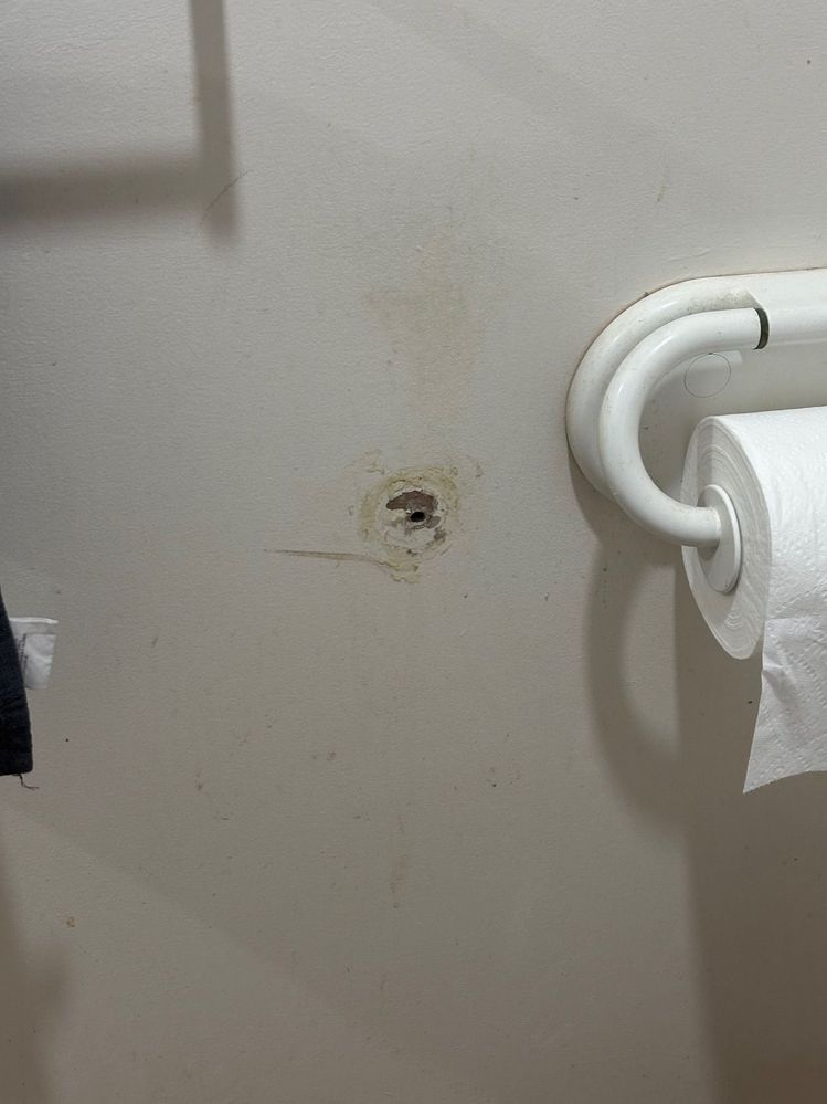

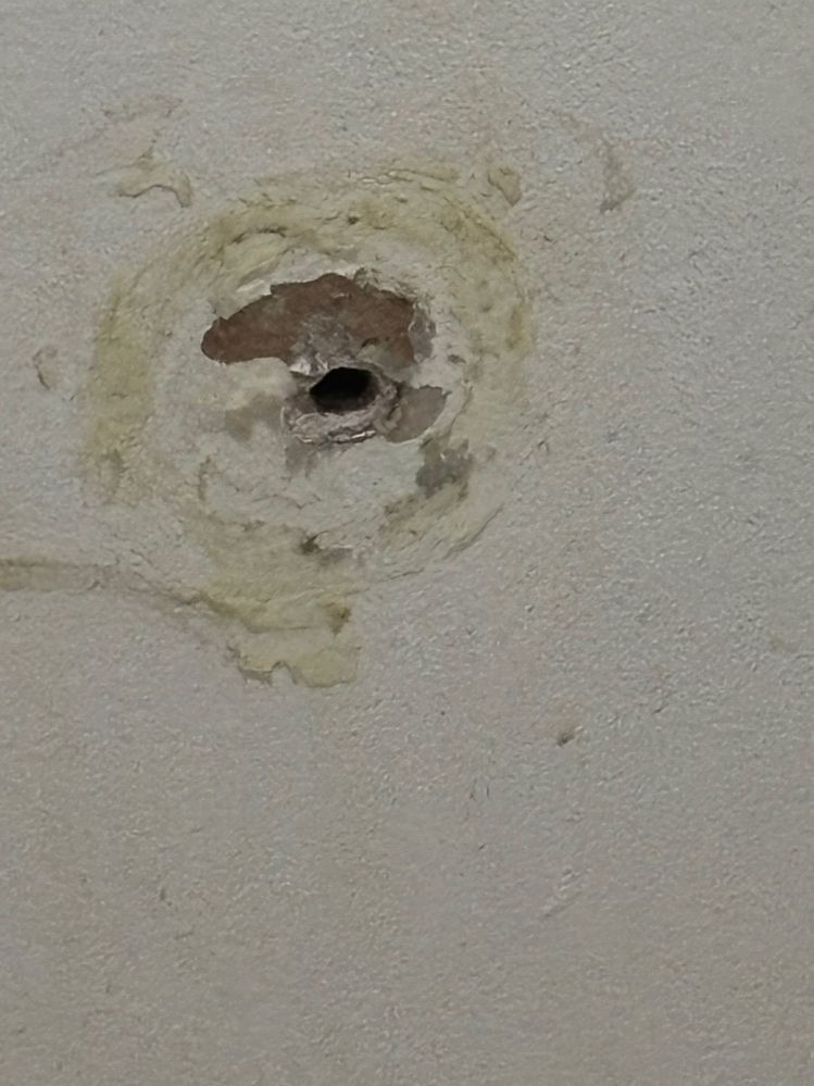

I tried to use two wall anchors both of them their legs not expand like the fifth attached photos (from Bunnings website) and hence
the anchors were spinning inside the hole

Your problem is  fixable a couple of  different ways.
All we  need to do is stop the anchor spinning in the wall so the  metal starts expanding and grabbing the wall behind  as it was  meant to.
1 ) If the anchor can still pull out with out force i would  wrap some tape (any tape) around the shaft just behind the large flange enough so when you reinsert it into the wall the anchor dosnt rotate at all just so you can use a screw driver to activate the clamp.  Instead of  tape a strip of paper wrapped around might work to if it willl fit in the  hole making a friction  fit..  If  fit too tight  shorten  paper strip or tape so theres less thickness to the shaft.
2 ) with a  pair of pliers grab the  large flange and hold it while  you have some one turn the screw to expand the anchor enough so it starts  grabbing  inside the wall as it was designed too,
3 )  Take anchor out and add some glue (probably any  glue) to where the back of the large flanges  shaft touches the inside of the wall. (not all the way along the fastener.
Good luck  hope this helps
