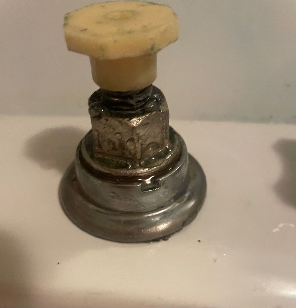

Hi i'm a new DIYer
How do I remove the "base flange" to enable me to replace with a new basin top tap assembly.
There are 2 grooves "cut out" is there a specific tool to use to turn the "base flange" to  remove it.

Just a couple of ideas - after letting WD 40 soak in.
An adjustable angle grinder spanner with the pins located in the notches.
But I suspect they will slip.
My preference would be multi-grips with curved jaws for a better grip on the cover. These are a Crescent brand form Bunnings. Lovely product.
Let us know how you get on - success or failure.

Hello @JeffDIY1966
My apologies for the late reply. It's great that you've received excellent suggestions from @Noyade. If you are no longer going to be using the old basin set, I would go with the suggestion of using a Multigrip Plier. This will anchor onto the body of the locking flange and allow you to turn it.

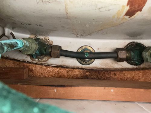

Re: How to remove the base flange of an old tap?
Hi Eric,
here is a photo of the underneath of the sink set.
is this the copper T set that you mention?
there is a hot tap, spout and cold tap sets.
I have a multi grip plier set but I was advised that I could cause damage to the pipes below if the “ locking flange” has seized up!
I haven’t tried any other devices like the strap device.
Hello @JeffDIY1966
Thanks for the extra information and photo of your sink. That's exactly what I was referring to which is the copper "T" join. Looking at the photo, I'm afraid there is not enough room to turn the body in that space let alone fitting a tool to do it.
Because the basin set is joined together by the "T", the basin set is quite firm and there should be no issue with you twisting the flange off. However, if you are still worried, I suggest removing the connection of the hot and cold pipes going into the set. In that manner, even if the basin set should twist it will not affect the plumbing underneath.
When you purchase the new basin set, it's a given that the connection to the hot and cold pipes will need adjustment and it might be necessary to cut or add to the copper pipe underneath.
