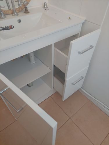

How do I remove the drawers on the estilo 750mm vanity unit.

Since Estilo is closed during the holiday break, let's try to solve the issue now. Please push the bottom draw in and then take a picture underneath the top drawer showing the drawer slides and any mechanisms. As @Jewelleryrescue mentioned, there's likely a mechanism to depress that will allow you to remove the drawer. Also, try the old-fashioned method of fully pulling the drawer out, lifting the front at an angle, and continuing to pull it out.

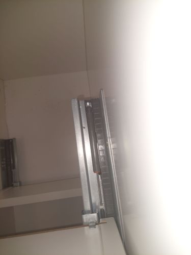

I have taken photos of the rails but it is a very tight space and cannot be seen without a camera.

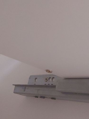

What about the front of the runner from underneath @hprider?  Your last image shows the back of the runner, but typically, there would be a button or lug that needs to be pushed in at the front of the runner to allow the drawer to run off the end of the slider.
I have see mechanisms where the front of the drawer needs to be removed to access it.

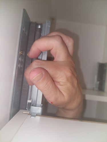

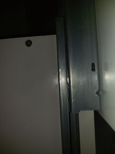

There are no visible levers or ones that I can feel at front of the runner.
Please see photos.

Hi @hprider   Both  myself  and @MitchellMc  are expecting to find a release mechanisim for those draws somewhere yet it is defying  the normal draw sets functions.
The last straw method is to  pull draw out looking for peep holes through the slider and undo the screws mounting the  metal slider to the draw timber itself, . To reinstall is the reverse of this. But with drawer closeto wall the wall side screw hard to access.
Sorry this is turning into  a bafffing  mystery where it should be easy.

There don't appear to be any obvious mechanisms to release the drawer from the runners @hprider. I'd suggest the next move might be to remove the drawer front to see if that reveals any hidden mechanisms.
