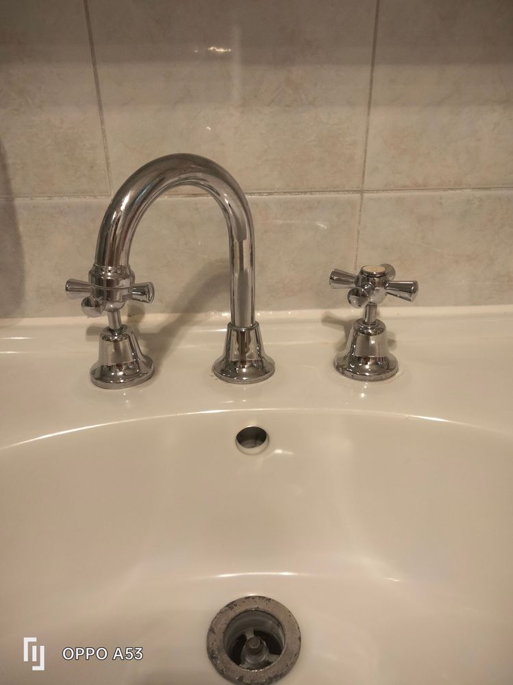

How to tighten nut under face bowl outlet tap, it leeks. Requires special tool, I am not sure if Bunnings carries a plumers tool. Had to turn tap to the left to tighten and to stop leek.

Is the water leaking into your bowl under the cabinet? If it is, it could be the o ring seals of the spout have given way causing it to leak. I recommend changing them before you tighten the nut of the spout.
I propose using the Kinetic Assorted Sizes O Ring Kit in combination with the Kinetic 15g Tap Lubricant.
If you are after a tool to use under the sink, I suggest looking at the IRWIN 280mm Basin Wrench. It's designed to reach into hard-to-reach places when installing plumbing fittings.

The water is leeking from under the middle outlet, (fixed outlet) under the basin. This assemble was replaced recently by a plumer, and I have lost his contact number. I purchased a Irwan renche from Bunnings and found that their was no room to get this rench in a tiney space.
I thank you for your advice but it seems that I will have to call the experts in, I am just to old for this.
