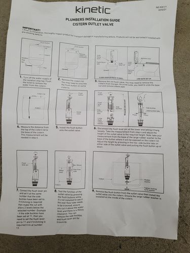

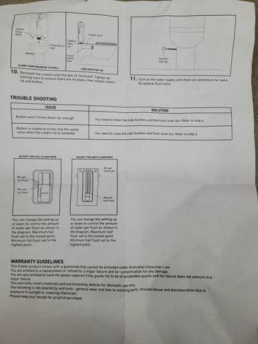

Is there an printable installation guide please ?

Take a look at this useful guide from Fix-A-Tap. It gives general information on how to remove a toilet outlet valve. Remember to check local plumbing regulations before commencing work.
The removal process is relatively straightforward after unscrewing the large nut where the flush pipe is connected to the cistern. Let me know if you get stuck at all, and I'd be happy to troubleshoot the issue.
Hi @Anth
It's great that you've found the paper guide for the Kinetic cistern outlet valve. One of the most important parts of the guide is to adjust the height of the flush button mechanism to the height of your toilet cistern cover. If not adjusted properly you won't be able to put the cover back on.
When you begin taking the cistern apart. I suggest observing carefully how you remove the old flushing mechanism. How it's removed is how you will re-install the new one. Put the new flushing mechanism next to the old one so that you can compare their height. Observe carefully the height of the flush button. Remember not to overtighten the locking collar at the bottom, you want it firm but not overly tight. Too much force will snap the collar and you will get a leak. If you have any other questions we can help with, please don't hesitate to post them.

Good news, it works like new !
Thankyou all for your help.
