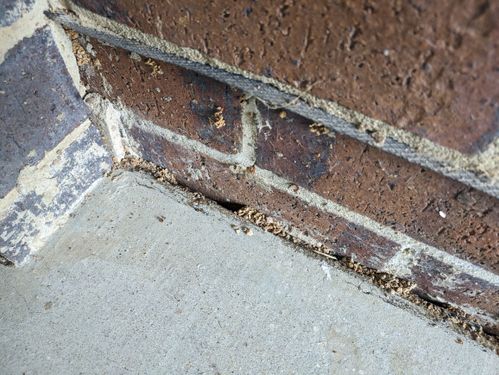

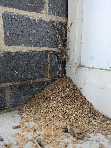

There's a ~ half cm gap between my garage floor and brick wall. I've had little pebbles coming up through the gap - think it might be ants? Especially in the corner near the front door.
Is there anything I can do to seal these gaps?

It looks like it could be ants. I recommend you start by sweeping up all that debris. Take a container of Ant Killa Dust and puff it down into the gap over its full length. Next, push filler rod down into the gap so it sits around 5mm below the surface. This prevents using excessive amounts of gap filler. Follow this guide on How to apply silicone sealant and fill the gap with Sikaflex 11FC. You can then wet a finger with water and a little detergent and wipe it along the sealant to smooth the joint.
This should effectively prevent the ants from using the joint to access the garage.
