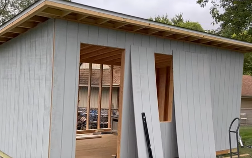

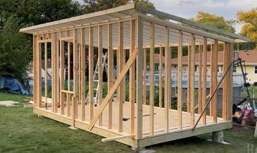

I want to build a shed like this. What kind of timbers should I get from Bunnings? Is it possible to use timber rather than steel for roof? It is because I don't have the tool to cut steel. Thanks.
Thanks for those images, @Makita.
You need to select a timber suitable to span the distance, and that can support your roofing material (roof load). You can see in the span table I've included below from one of our timber suppliers Hyne, that 140 x 35mm timber at 900mm centres will be suitable for your project. If your roof is sealed to the elements, you can use 140 x 45mm Framing MGP10 H2 Blue Pine L/M, or if it is exposed, 140 x 45mm L/M Outdoor Framing MGP10 H3 Treated Pine - Linear Metre.
Please let me know fi you have further questions.
