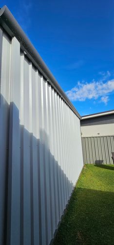

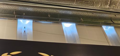

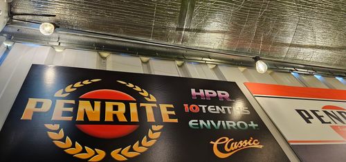

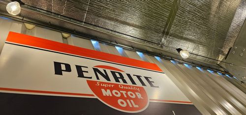

Having an issue with our new shed that I built. During heavy rain water seems to splash onto underneath the roof sheets and drip onto purlin / inside wallsheet. Isn't a big amount but enough to form drips on the top purlin. During very heavy rain I had about 50c size puddle on the floor in 1 spot. Would something like trimdek seal be enough to stop this?

I agree with your proposed solution, Trimdeck seal should be adequate to stop the leak that is travelling along your roof line. Another option would be to use Bastion 1200 x 600 x 30mm XPS Multi Use Foam Board, but you would need to custom cut each piece into shape so that it fits the gap.
Afternoon @Triggy
I was looking at your pics during lunch and was trying to think of something other then expanding foam to solve the issue, I do liek the solution from @EricL with the trimdeck idea to fill the gaps. Not sure if you would still get whatever splashes running down the walls a liitle tho. Maybe the expanding foam would also help seal it?
Thanks for the replies guys, so I'm going to do a bit a trial and I'll do a update once we get some more rain, I suspect the way it's come in is its only the protrusion on the trim deck that's letting water drip off the underside of the roof sheet and down so I've cut up the trim deck closed cell foam and put it into the protrusions for a couple meters worth. Fingers crossed 🤞 it's only a few drips so hopefully this should be enough 🤞I think the expander foam is probably the best thing to seal it but I'm not sure how I'd do it with out making a mess/looking terrible.

If you decide to use the expanding foam, you'll need to use a custom cut cardboard holder which you'll need to make yourself. This will keep the foam in place until it expands and settles. Once it cures you can then slowly remove the cardboard.
