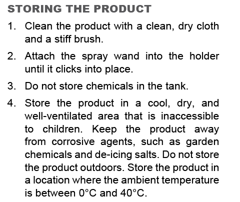

if your going to pull it apart, this video may help. And here is the mention of not storing chemicals from the manual. The idea is you're supposed to flush the system out with fresh water then store empty and dry. But they don't give you that level of detail in the manual. But I do know thats whats required for this machine. It had been a very common issue and hence why the hand-held sprayer has gone to a completely different design.

@Nailbag thank you this video is exactly the kind of thing I reckon will fix it. I’ll let you know how I go. Also the tips on storing it after use are very good, I don’t think I recall seeing that.

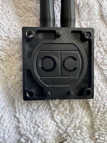

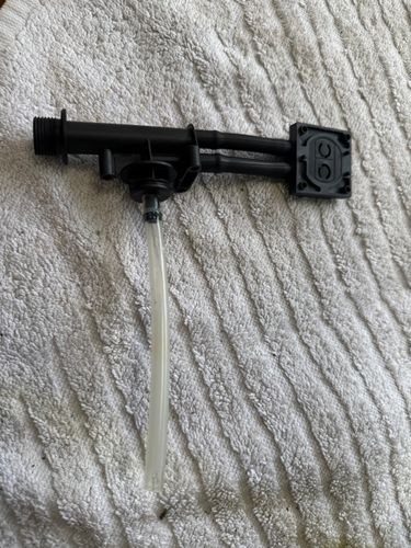

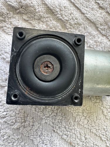

philt
Getting Established
Re: Ryobi weed sprayer not working
@Nailbag Thanks mate it works, finally! Interesting I pulled it apart as shown in the video but the clogged up bit in that video was completely clean in mine. So just in case I soaked the internal hose and reattached everything and it now sprays. Just need a new measurement cup as the bottom just disintegrated. Cheers
