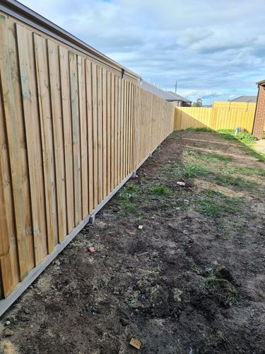

About to set about laying down some turf after a new home build, and thought I'd ask for some opinions.
It's a clay soil, so I plan on spraying some weed killer around, letting that settle for a week or so, then using a rotary hoe, then putting about 20mm of premium top soil down before laying the turf. Would you agree?
As you can see in the image, there's quite a fall in this part of the yard, from right to left, do you think it would be a worthwhile investment running and Agi parallel to the fence about 500mm away, to avoid a soggy mess in this part of the lawn next winter?
Any other pointers please don't hesitate to say as its my first time doing this and I'm quite the novice.
Cheers. Craig.
What's on the other side of the fence? Wouldn't the water just keep running under and down the hill?
I think it would be best to avoid building the ground level up higher than the bottom of the fence, so it doesn't rot. Same for the damp course of the house.
I can't remember how much topsoil I put under ours, but it was way less than 20cm. Check the turf supplier's website for what they recommend.
There's another house on the otherside of the fence, so I'm aware of not allowing water from my land flow into theirs.
Only looking to do 20mm (2cm) of Topsoil so it won't effect the integrity of the fence and it won't be up to the wood.
Cheers.
I read it as 20cm!

Hi @vegie82,
You're already at a huge advantage in your project due to the fact that you have thought it through, meaning you're way more likely to succeed. For gardening soil type plays a big part with clay less free draining but able to hold on to nutrients better, sand the opposite free draining but nutrient leaching.
Adding a high quality top soil is a great start, and grass is shallow rooted so 20mm will be plenty allow the turf to establish roots before encountering the clay later on.
If you're worried about water pooling at the bottom of your yard ag drain will be able to redirect the water, but you will need to have a think about where you want to let that water out as the pipe will need to run downhill, and continue to drain downhill to wherever it terminates. This could mean digging quite a serious trench to be able to carry the water away.
You could consider planting waterlog tolerant shrubs or trees along the fence that will enjoy the additional moisture content of your clay soil, and will help to keep the moisture from sitting on top of the soil.
Best of luck with your project!

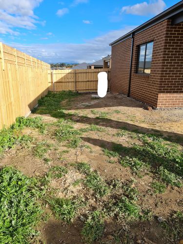

I have concrete getting poured in 2 weeks, basically the permitter of the house in the photos, and 1mtr wide. I'm interested to see what the finish height will be between the natural ground and the concrete height as this will effect how I will battle the preparations and calculations.
I assume I want the base of the grass leaf of the turf needs to be the same height at the finished concrete level? Asking that, how thick is a slab of sir walter typically? This will allow me to calculate the thickness of topsoil I'll need to lay, especially once I've finished scrapping the weeds and rotary hoe'ing the clay.
For the drain, I was thinking AGI, because the distance in the photo below between fence to fence is approx 18mtrs, and the width is approx 4.5mtrs. You can see a natural fall in the length of approx 0.5, with the LPOD only just visible in the photo about half way between the house and back fence on the far side (ofcourse it's painted black, making it harder to see). So I could easily connect the Agi to the LPOD using a pit and taking advantage of the natural fall, however is 0.5mtr fall over say 16mtrs insufficient for a agi pipe?

Hello @vegie82
Thank you for the project update. The thickness of Sir Walter 0.5m² DNA Certified Soft Leaf Buffalo Turf Slab is around 40mm. It may vary as the bottom of the pile usually gets compressed, please take this into account once you begin laying it. Having the turf at the same level as the concrete will work. Please take into account the level of the lawnmower when running over the edge of the concrete and turf at the same time. If the turf is too low you may hit the edge of the concrete with the mower blade.
A good way to test water flow is to dig a shallow channel where you plan to place your Vinidex 100mm x 20m Slotted Draincoil. Once you've made your channel. Use your garden hose and run water into the channel. It should flow down to the other side where you wish to direct the flow of water. This will give you an indication of how deep you must dig your drain to get the correct fall.
I recommend asking a registered plumber if you can D.I.Y. a connection to the LPOD or if it needs to be a registered plumber. Some states have strict rules on connecting to LPOD. I suggest using a french drain design, it provides a nice visual border and it prevents fine soil from clogging up the Slotted Draincoil. Please keep us updated, we look forward to seeing your turf and garden ready for use.
