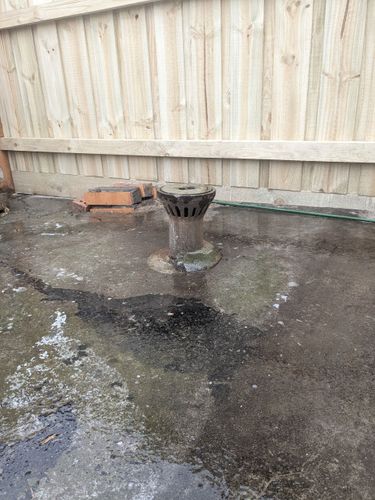

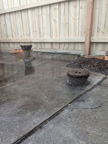

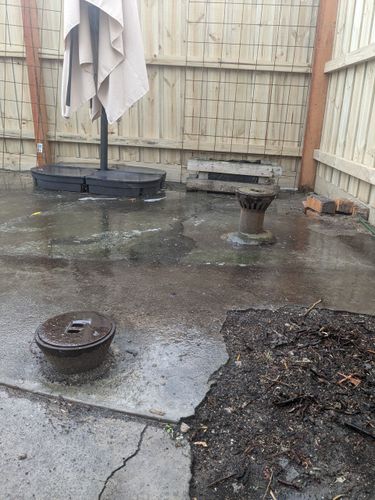

We've got these sticking up in our backyard. Can we do anything about them? We think they're vents for the Sewage. Happy to keep them doing their job but we'd love to make them stuck up less. Any thoughts?
Welcome to the Bunnings Workshop community @Mandrew. It's wonderful to have you join us, and many thanks for your question about sewer pipes.
Quite often, sewer vents/access ports are located at a specific height due to regulations or elevated toilets within the building. I'd suggest the easiest solution would be to enlist the services of a plumber to assess the installation and, if possible, adjust their height to be flush with the ground. However, I suspect that if it were practicable to install them flush, they would have done so in the first place.
Alternatively, you might like to look for ways to conceal them. Perhaps an enclosed timber bench could be built over them. Bear in mind that you'll still need to access them on occasion.
