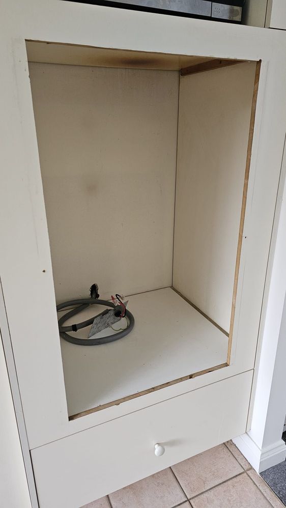

I bought an old place and moved in to find the oven didn't work. It was an old Chef Integra Baroness that had a separate grill. I have a new standard 60cm oven ready to install but does not have a grill and is a bit wider so I need to modify the cabinet. I've not done this kind of thing before but don't really have the spare cash to spend on a cabinet make, plus the kitchen is old and tired so it doesn't need to look incredible.
The current cavity is 765 wide 960 high and 589 deep (rear face of front panel to wall)
The current opening is 545 wide 905 high and 16 deep
The new oven requires a hole 560+8 wide, 590 high and 550 min deep. I want to modify the cabinet and add an off-the-shelf drawer underneath. I have some questions interlaced in the steps I plan to take below. Appreciate any help.

Pic below.

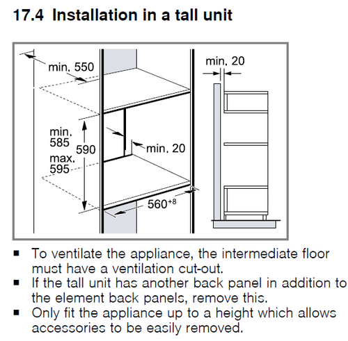

Hi Jacob
Thank you for your response. I have assessed in accordance with the installation instructions in the manual and my intentions meet all required clearances.
For support, the manual does not address the mass of the oven and thus support weight requirements. It states that a resistance of 90 degrees celsius is required from a heat perspective. I intend to have the oven installed by a licensed electrician, but want him in and out, installing the oven onto a pre-prepared cabinet that is ready to receive the oven.
I just need to know the material and thickness of shelf to meet the requirements based on being supported on two opposite sides only (which I presume most are since there is always a ventilation requirement at the rear edge) spanning 765mm wide. I also wanted ideas for support of the shelf but I will just go with the 2x100x300 timbers and shims to make up any additional thickness if no other ideas are thrown my way.

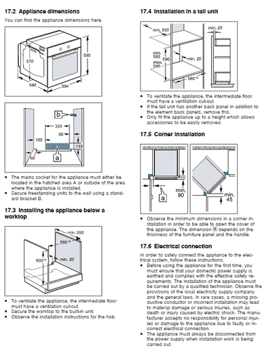

Hi Mitchell
There is nothing in the manual about rails. The model is a HBF113BR0A.
User manual and installation instructions HBF113BR0A | Bosch (bosch-home.com)
Nothing depicted below either. As you can see from the original picture there were no rails on for my original oven either.
