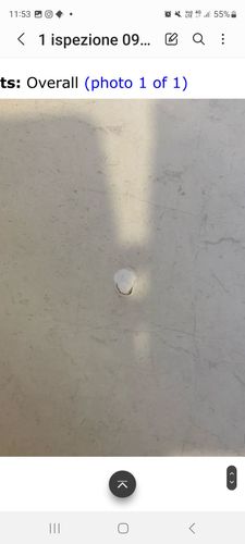

I need to repair this on my kitchen bench top. I would like to know if I can buy a sort of filler at bunnings.

I'm looking at the photo you posted, have you attempted a previous repair on the damaged area? It looks like it already has a filler in it. Will you be removing the old filler and filling it with another filler? If you are, I suggest looking at using Selleys 50g Knead It Aqua Epoxy Putty.
The putty can be pushed and flattened by hand, and it is possible to sand it down once it has fully cured. Please note that it dries to a light grey and will therefore need to be painted over with a colour that is similar to your benchtop.
The advantage of using Knead It Putty is that it is heat resistant, waterproof and works on various substrates. My best advice is to use only what you need and make sure to fill only up to the surface of the benchtop. This will save you from having to sand too much of the repair area.

Just a quick follow up to my suggested solution to your damaged top. Is your benchtop by any chance a stone top or is it a laminated top? If it is a stone top, I suggest contacting a stone specialist that deals with this type of damage. Unfortunately, neither a filler nor putty will work with this type of damage.
However, if it is a laminate surface, one other type of repair you can do is to fill the damaged area and repaint your benchtop using the Dulux Renovation Range. It is formulated to go onto laminated surfaces including benchtops.

So...yes it was repaired but not from me so I was wondering if taking the old one I could do a better job. Yes it is laminated,i saw Pc-11 as well but do know if suitable for it. U suggested aqua. What do you think?and thank you so much for ur replied.

PC-11 is a good product and is at par with Knead It when it comes to sealing. I leave the choice up to you to which filler you want to use.
