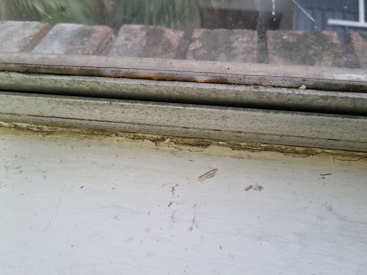

How would you repair cracks between an aluminium window frame and brick window sill?

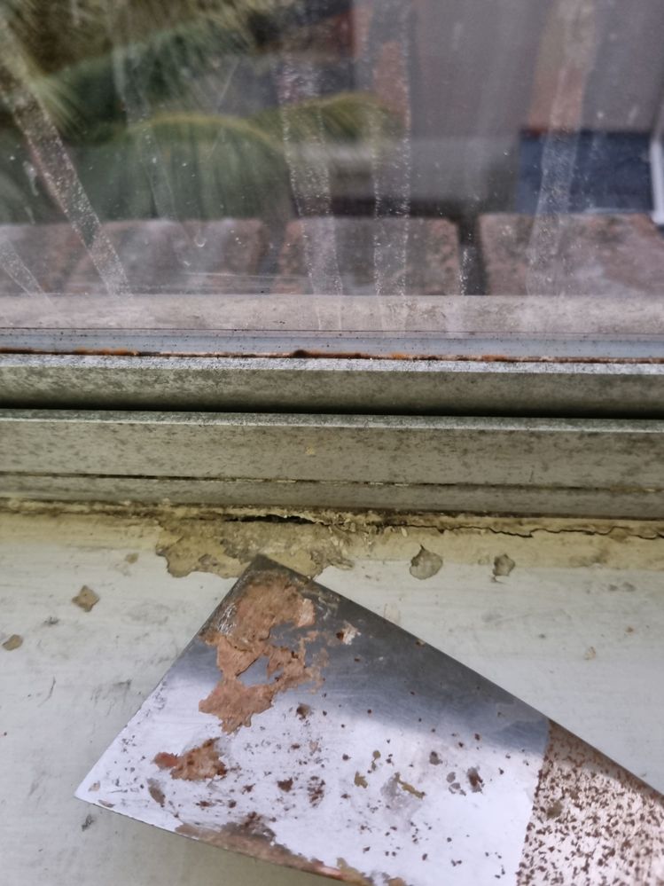

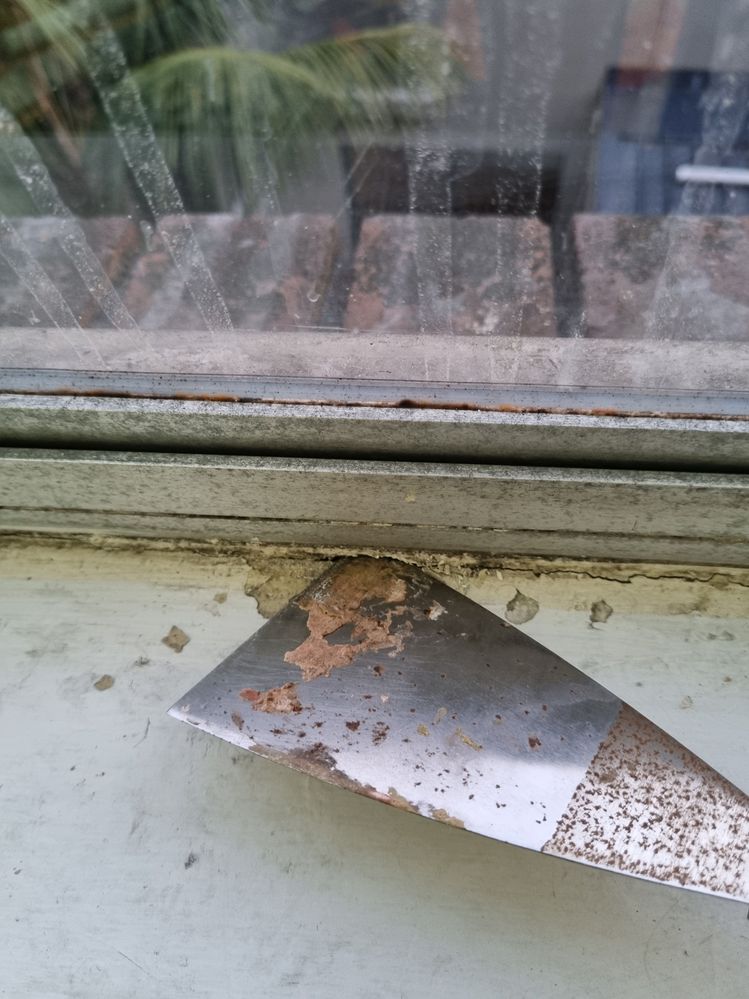

They looked like cracks in the paintwork and I started scraping off the loose paint/masonry/sealant? which revealed a gap between the frame and sill (it does not penetrate through to the outside), and there is a hole in one location.

crack look like its just in paint work
gap
close up of the crack
hole
hole
Hello @Star
Welcome to the Bunnings Workshop community. It's splendid to have you join us, and thank you for sharing your question about repairing the cracks near your window frame.
You are definitely on the right course with your repair job. The old gap filler that was used has petrified and turned hard and should be replaced. Cracking and splintering are often sure signs that the filler has expired. I suggest using Selleys 475g No More Gaps Interior Multipurpose Gap Filler in combination with Paint Partner Skeleton Caulking Gun.
I also recommend using Painters Masking Tape on your window so that you'll get a nice straight line when applying the gap filler.
Please make sure to wear personal protection such as gloves, goggles and a mask when working on your window frame.
Here is a handy step-by-step guide: (the techniques used are applicable to your current project)
