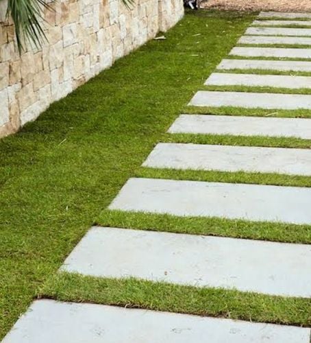

I want to make a garden path kinda like the image, stepping stones between grass. It will lead to the pool.
The pool has beautiful travertine stone capping and has nice 400x400 outdoor tiles around.
I would love to have travertine pavers but my budget is next to nothing as I am on maternity leave.
The previous owners who installed the pool left a heap of the spare outdoor tiles. I know I can't just use tiles like pavers as they are too thin. However could I glue them to the top of cheap 400x400 concrete pavers, almost like a veneer? If so what would I use to secure them? Sorry if this is a ridiculous question... I'm inclined to think it's bot possible as I couldn't find it on google lol
