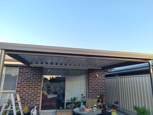

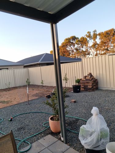

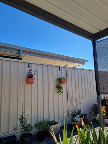

Looking for suggestions on how to tackle shade options to attach to my stratco sanctuary pergola that was put up a short while back.
My yard gets very harsh west sun in the late afternoon/evenings and ultimately makes this area pointless.
Pergola is also a custom size 3.48m width.
Unsure of where to start.
Difficult to get great pictures but hopefully the message gets through.

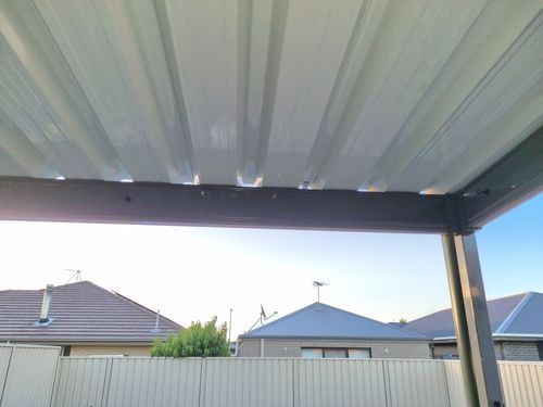

Thanks, I think I am understanding the temporary option in attaching to the sides. Attaching anything to the top is a little difficult as there Gutter and beam are so closely attached there is no gap/holes to be able to thread anything through.
The timber attachment might be an idea however I haven't worked much with metal and I'm not sure how to attach this?
I think in term of purchasing a blind I'd be more inclined to avoid the channel blinds, perfect the roller blind look.
Previously sought out prices from blind companies and nearly fell over with what the costs involved were 😅 with and without installation costs.  Didn't seem viable to spend 1/2 of the cost of the Pergola itself on one blind!

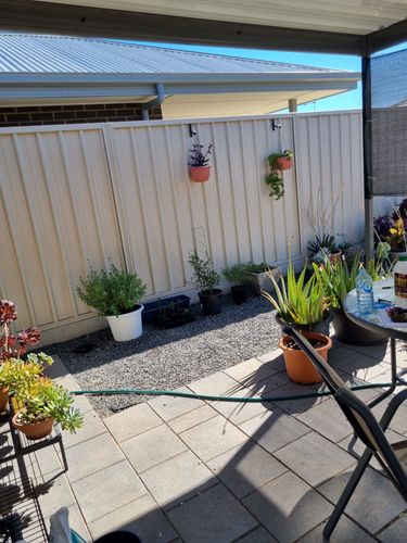

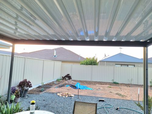

Thanks @MitchellMc I think I understand. I have temporarily fixed a shade cloth with zip ties for upcoming hot weather until I can get to work on something more permanent.
As @Jewelleryrescue suggested also looking into some raised beds, considering something perhaps like clumping bamboo or that might grow high to block.
Unfortunately with my temporary attachment of shade cloth and watching the sun it hasn't quite covered all the areas I was hoping. Even with the future blind plan I will still have hot afternoon sun coming through on this angle as you can see
On this side there is no additional post as it connects to the roof.
 Any ideas?
