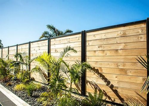

I want to build a front fence like below using colourbond posts and timber panels horizontal.
I'm curious is the posts would be able to support the timber? And what timber would be best?

I was thinking these posts look like the picture with timber slats
https://www.bunnings.com.au/colorbond-steel-fencing-post-night-sky-2700mm_p0910755
The fence would be 1800 above ground, but could drop a little if needed. It's for enclosing front garden, so wanting high enough for privacy of people walking past.
Than capped with matching rail.
The post link you added I had considered as additional strength. But I like idea of the Jack Screen up system without spacers using end, corner and join posts (https://www.bunnings.com.au/jack-1970mm-screen-up-joiner-post_p1100965)
I'm keen on lighter natural looking wood. So I guess treated pine would be best.

I had thought 200Hx50Wx1200L h 1500L - posts apart 1.2/1.5/1.5/1.2 = 5.4 along front & similar done size with slight span adjustments, but was worried it would be too heavy going up to 1800. This was I could bury first sleeper in ground to have a small retain at the street front side. Capped with top rail.
With the Jack Screen Up posts I'd have to use 19mm timber.

Typically, you'd use thinner screening material for a fence rather than very thick treated Pine sleepers @tophnay. You could use sleepers, but their weight would require everything to be beefed up, including bigger posts, and deeper and larger footings. You might like to consider treated Pine plinths instead of sleepers as they are 150 x 25mm instead of 200 x 50mm.
