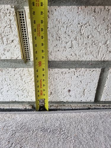

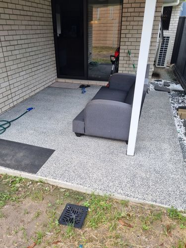

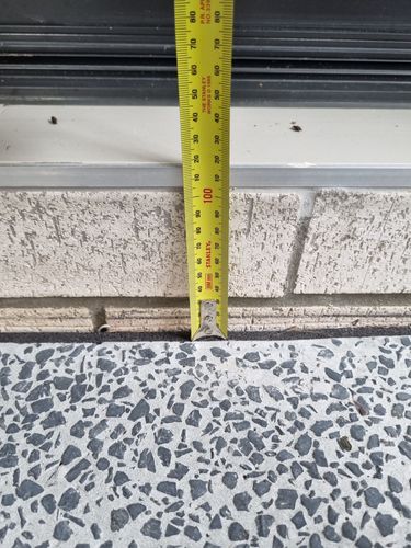

I am planning to install modular decking on the alfresco. The issue is, there are 5 weep holes that are approximately 100-110 mm from the floor. The minimum height of the modular decking is 110mm. Can I close those weep hole or part of it if I install the modular deck.    
Any suggestions/ feedback would be appreciated.

Hi @Mos I would just leave them as is. They shouldn't interfere with you deck construction and blocking them up could effect their purpose.
Re: How to build a modular deck over alfresco exposed aggregate?
Hi @Mos,
Partially or fully blocking the weep holes is not a good idea and likely would be against construction codes. The weep holes allow your walls to breathe and drain excess moisture. If they were partially covered, it would lead to damage in the wall structure. I recommend having at least a 5mm+ gap between your deck structure and them; do not place the deck structure hard against them.
