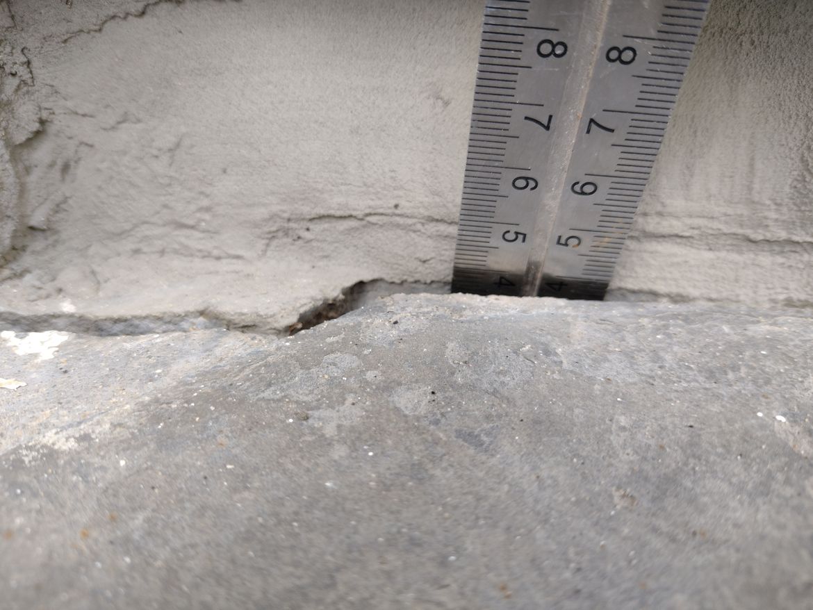

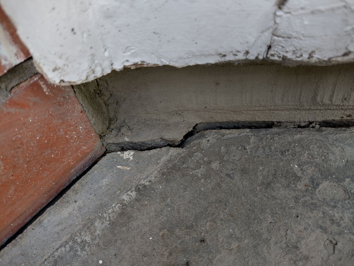

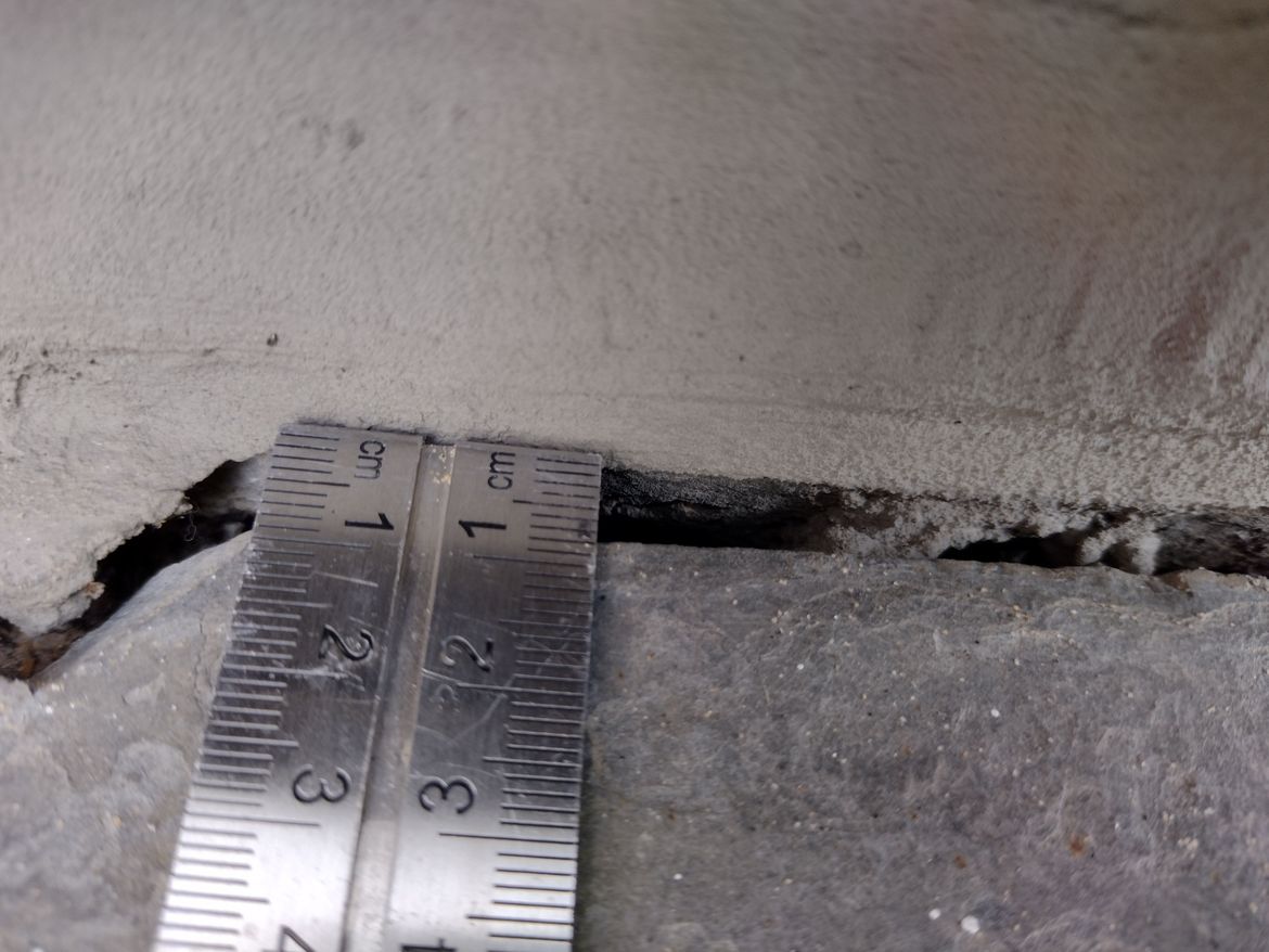

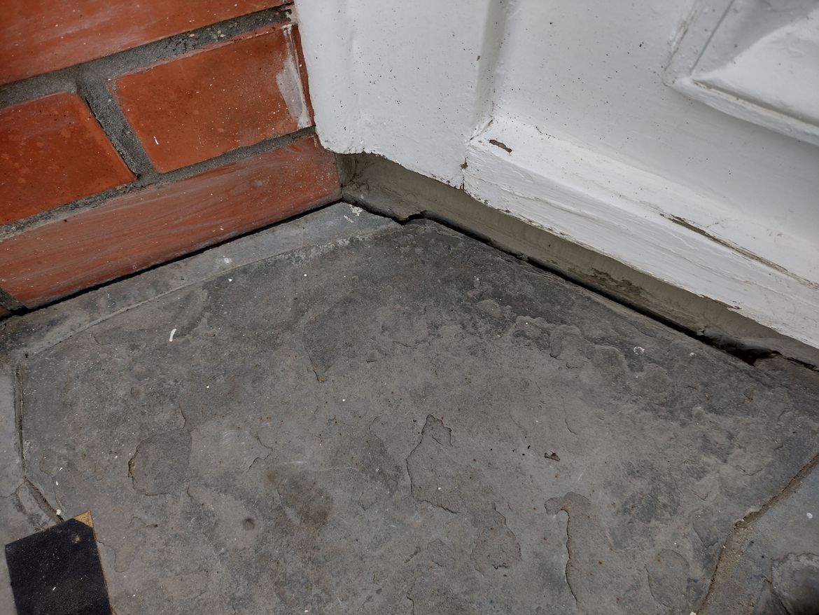

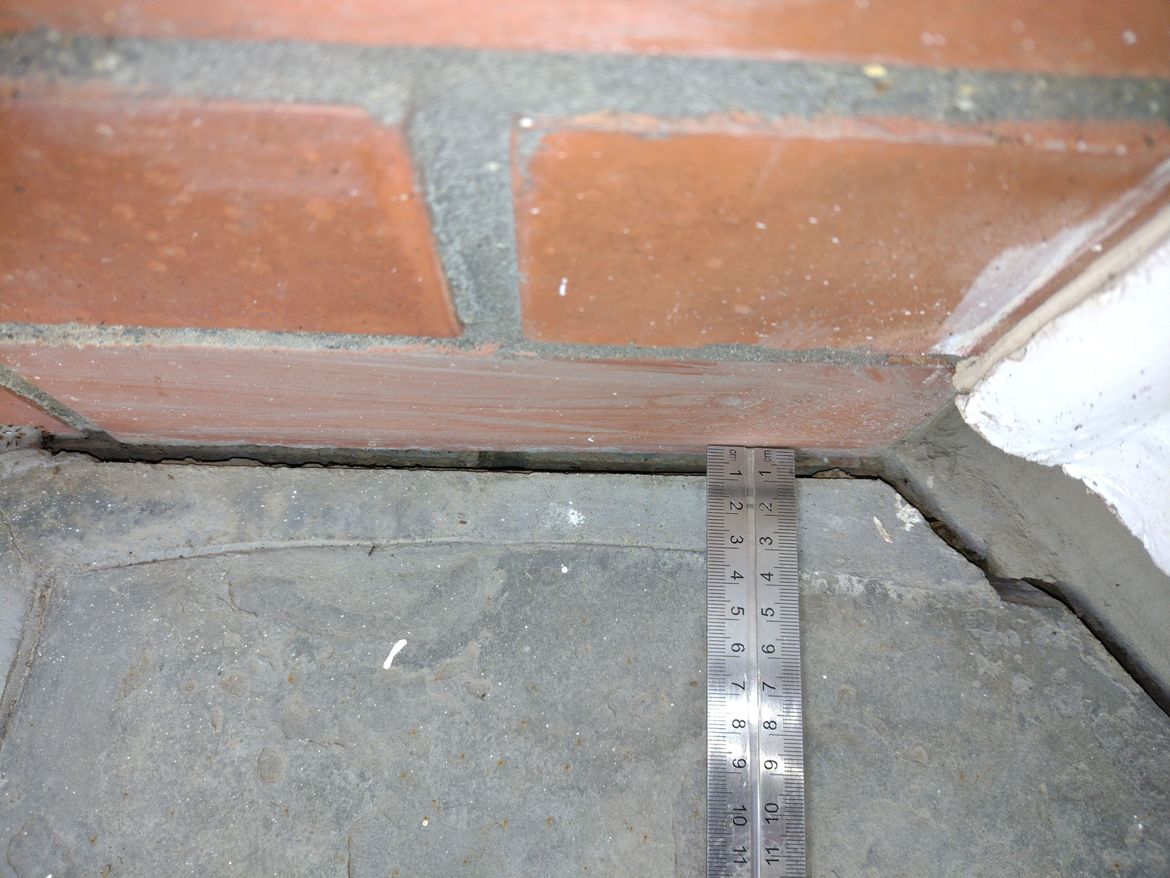

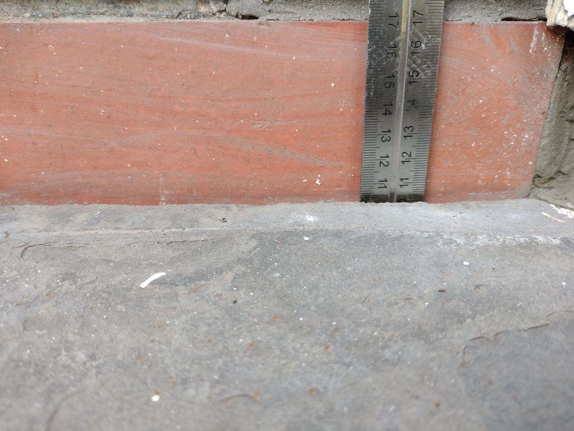

Hi Bunnings Team, a question on this crack.
I have a crack between the brick wall and a concrete patio area that then bends round beneath a bay window. As seen in the pictures the gap is about 1cm wide, and the depth varies from between 10.5 cm against the brick to 3-4 beneath the window. Wondering what the best way t0 fill this would be.  My initial thought was back fill the crack with paving sand then put a backing rod e.g. Moroday 10 mm on top, then Silkaflex Pro+ on top of that ( not sure what depth to do the silka to ie between top of rod and the 'ground' level). But also thinking a sturdier option might be to fill with Dunlop Ardit (which I have on hand from patching other concrete areas) particularly for the section between the patio and under the white painted timber of the window as on the other side it all sits flush together. My main concern is water getting in the gaps etc.
Any advise on what I'm looking at and how to go about it appreciated.

I hesitate on the idea of using a backing rodd or filler. To me an easy fix in this case may be better (less materials to go wrong). I just had a look at sikaflex website itself and the spec sheet and it really looks like you could use it for the whole seperation area.

The purpose of the gap filler rod is to prevent the Sikaflex from flowing down the gap. It's just a temporary holder and once the Sikaflex cures on top of it, it will no longer have to rely on the gap filler rod. I believe a 5mm space should be enough to provide a sufficient seal.
Please make sure not to push the gap filler rod too deep into the crack and remember to leave space for the Sikaflex to settle on.

Thanks @EricL and @Dave-1 I misinterpreted the purpose of the filler rod to 'fill' completely rather than provide a 'base' for the filler itself. Will give it a go with depth to width ratio as per Sikaflex guidelines.
