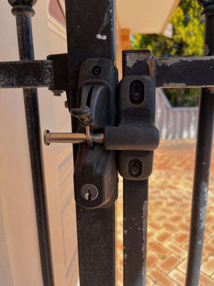

My gate lock is not working properly, can only lock from inside.
I am hoping to fix it myself.
Is it an easy job to repair or replace a new one? Any tips to replace a new one will be appriciated.
Or do I really need to get gate people or locksmith to do it.
Thanks in advance.

When I put the key in and turn it around, it just does nothing.

By the sounds of it, the locking mechanism has failed. This could be for a variety of reasons including springs losing tension, internal parts wearing down and overall wear and tear.
The simplest fix is to replace it with a new LokkLatch General Purpose Gate Latch. There's not much to it, you'll just need a drill with a phillips head bit to remove the old lock and install the new one. The instructions will show how to set things out and you may even be able to use the same screw holes.

Thank you for the reply, and yes, mine is the same like yours. The lock stop the latch to release.
mine got key holes on both side, and when I use the key, one side can lock, but another side can’t.
I think is like JacobZ said something in it was broken.

I think I will need https://www.bunnings.com.au/lokklatch-deluxe-s3-gate-latch_p0336015 this one with key holes on both side.
I asked the locksmith to give me a quote for doing this job - $165 call out fee and $125 for the lock….so definitely want to try to do it myself!

That looks like a great replacement as long as your posts and gate are at least 38mm thick.
Having a look at the installation manual, you're going to need a couple of extra tools to accommodate the connecting rods that go through the post. You'll need a drill, a 4mm drill bit, a 13mm drill bit, a phillips bit, a square and a hacksaw.
