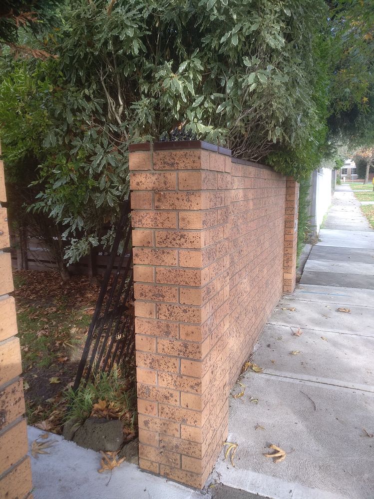

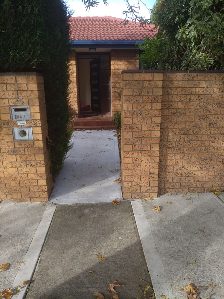

Hi. I want to install this gate outside to replace an existing iron gate outside. I will cut it down to the height of the brickwork:
1833 x 900mm Pre-Oiled Merbau Horizontal Slat Gate - Bunnings Australia
The current space is 1030mm, with brick columns 1650mm high and 350mm wide.
So I am thinking of attaching 2 x 42mm merbau "posts" to one side (effectively making a 84mm post) and a 1 x 42mm merbau post on the other side, as a 90mm post and a 42mm will be too wide. About 1650mm long so it looks nice and doesn't leave big gaps.
My questions are:
1. Does this sound reasonable?
2. What fasteners would be best to use to attach the timber to the brickwork?
3. Should the posts be 42mm x 42mm or 42mm x 90mm to be able to fit on the hinges and lock?
4. What hinges should I use?
5. Any recommendations as to what type of lock I should use? It would need to be opened from either side, and I'd prefer not to cut a hold to put my hand through. Lockable preferred but not mandatory.
6. Would you put the double-post on the lock side or the hinge side?
Thank you for your time and help.
Side view of brickworkSide view of brickworkFront view of brickworkFront view of brickwork

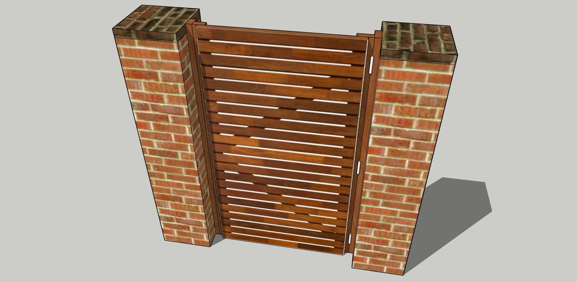

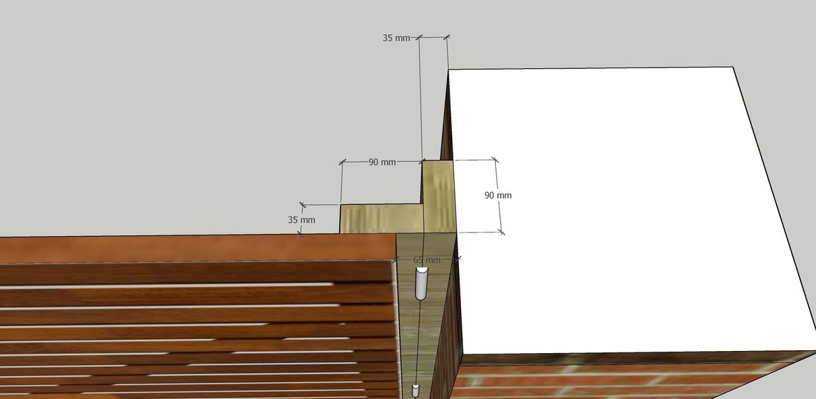

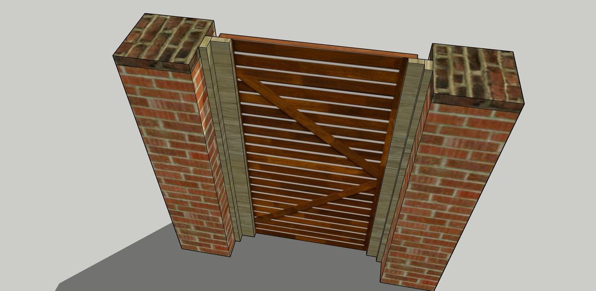

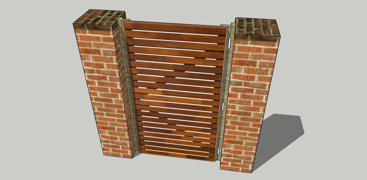

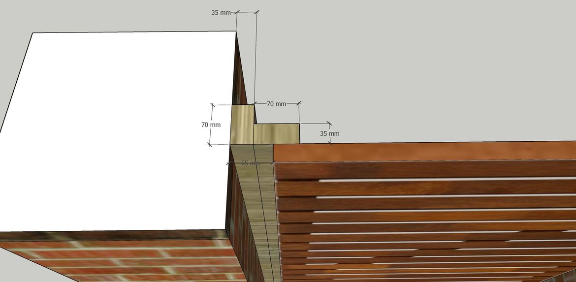

Thanks for sharing your question about installing a gate. To balance the gap between the fence, I suggest installing 90 x 35mm Outdoor Framing MGP10 H3 Treated Pine - 2.4m in an "L" pattern with the hinges installed in between. The side not anchored to the brick post is where you'll screw the gate onto.
I recommend installing a similar configuration on the other side but using 70 x 35mm Outdoor Framing MGP10 H3 Treated Pine 3.0m. It's not necessary to use the large 90mm x 35mm as it will not carrying any weight.
I suggest using either Dynabolts or AnkaScrews to hold the timber onto the brick post. I recommend using the Ikonic Satin Chrome Digital Entry Lock as a way to secure your door.
I've placed a sample sketch below to give you an idea of how it might look like. The final image at the bottom shows what it could look like once the timber pieces have been painted in Merbau.
Let me call on our experienced members @Adam_W , @TedBear and @JoeAzza for their recommendations.
AntonT gate1.jpgAntonT gate2.jpgAntonT gate3.jpgAntonT gate4.jpgAntonT gate5.jpgAntonT gate6.jpgAntonT gate7.jpg

Re: Installing a gate onto brickwork
Thank you Eric. I never considered framing it out like that. Really helpful. Thank you.
I might look at how I might adapt it to use Merbau instead of pine, which I think would look great just oiled rather than painted. But the concept and drawings are really helpful.

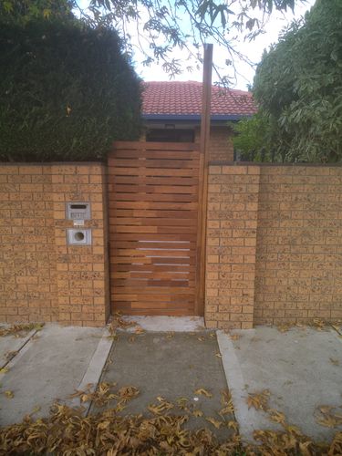

I'll buy the gate and hinges and do a rough fit (not bolted) with some rubbish posts I have here to see the gaps before I buy the new post(s).
Rough fit is looking great. I decided on the matching pre-oiled Merbau "posts" which look terrific. I will cut down the height, and decide on hinges (maybe self closing?) and the latch/lock. I'll post the final result when I'm done, likely next week.
