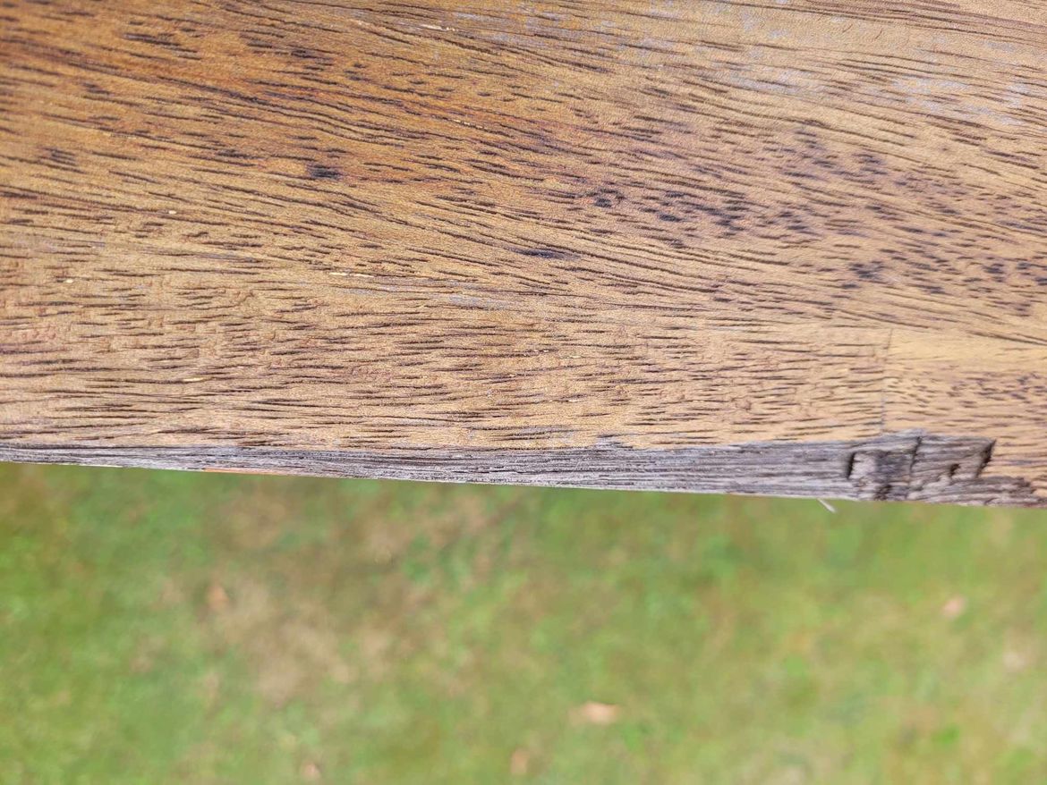

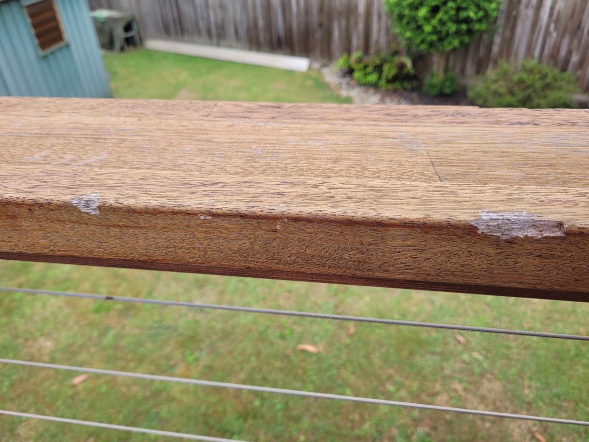

What is the difference between 'equal" & "unequal" aluminium angles.  May need to put around merbau railing to protect from cockatoo chewing - some damaged already413955163_2051895401838074_8404333748999600151_n.jpg417227556_742056774108402_3904142060083348536_n.jpg413310912_1331321680861872_4897161951798529763_n.jpg

I  am glad to be of help  to you again. Just to  be clear  the aluminium angle is a possible  bird solution that will look ok on your hand rail I cant guarantee this will work but it is a solid plan.
Equal  aluminum is simply both sides are the same length  eg 20mm and 20mm  There is usally a 3rd measurement the length of the material maybe 3.0 meters,  and a  4th measurement is the thickness of the aluminium eg 1mm.
Your  aluminum would be good at 1.6mm. thick  as it is supported by wood I would  glue it on  with any clear silcon, as silicon can be rubbed of  at need later and not mark timber,  You only need spot dabs to  hold it in place.
Unequal aluminium  might be 20mm and a longer  other side 40mm  .
For  your railing I am thinking  square  equal angle  16mm x 16mm x 3000mm (3meters) 1.6mm thick, As the birds seam to chew the edges first. sharpening  their beaks ?
