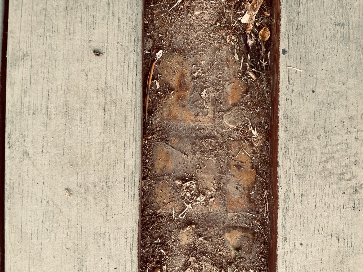

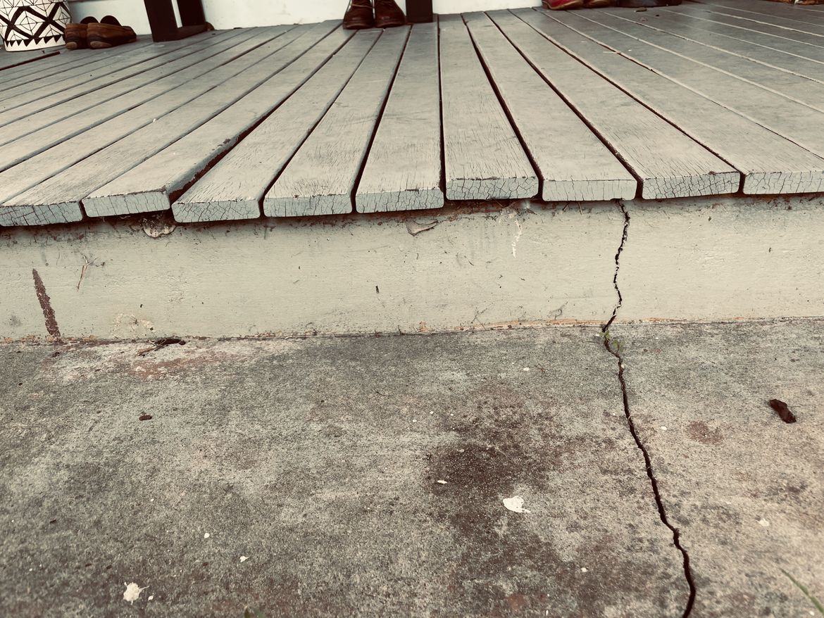

3 - If I screed, what do I need to think about, what issues might I face based on what you can see in my pics of the decking?
4 - If I don't screed and lay on the tiles, how should I fix them down?

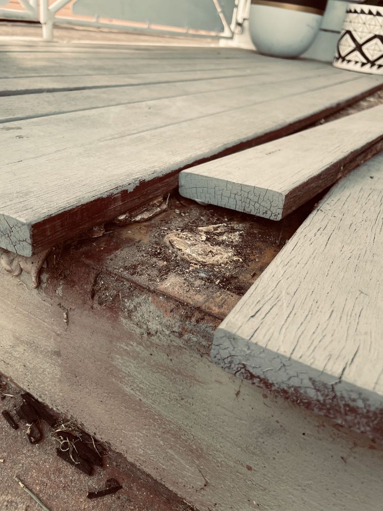

5 - What should I do about the step? Cover with long timber? That crack concerns me.

Your images show that the decking boards have been glued directly to the tiles. I can't see any benefit to removing the tiles and screeding the area unless the tiles themselves were uneven, causing the boards to be uneven. I suspect the boards are distorted due to the excessive moisture captured under them.
I can't offer much assistance regarding the best approach, as laying boards on a solid substrate is not something you see every day. Though, an issue you'll face when you pull the boards up is that the glue will be stuck to the surface of the tiles, and you'd need to scrape that off. If these boards have lasted a reasonable amount of time, then, by all means, complete the work as it was initially done; it's just not an acceptable building practice. But, if it works, it works.

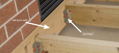

1 - I know I'm not floating my joists, but rather using dynabolts to secure them to the tile floor, however, do you think I need to add a timber frame across the wall like below?

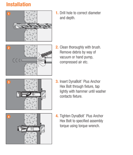

3 - Looking at guides on dynabolts, I think I need to drill through the tiles first before securing in? Is that correct?
4 - If yes to 3, I think I will then need to get a diamond tiip drill bit to drill through the tiles?
5 - Will the diamond tip drill bit also drill through the concrete without breaking it?

Hi @mrpatel,
The timber frame is not a necessity. Unlike the picture, your joists will be on their side, and the frame only really serves to stabilise upright joists.
I'd suggest using Ramset 10 x 100mm Countersunk DynaBolt Plus Masonry Anchor, as you'll be bolting through the face of the joist and tile and then into the concrete.
You will need to drill through the tiles first as you'll watch the Dynabolt to expand in the concrete. This Kango 10 x 120mm Multi-Max Multi Material Drill Bit will get you through the tile and concrete. You'll need to test whether using it in hammer mode cracks the tiles. If it does, run it in standard mode for the tiles and then switch to hammer mode for the concrete.

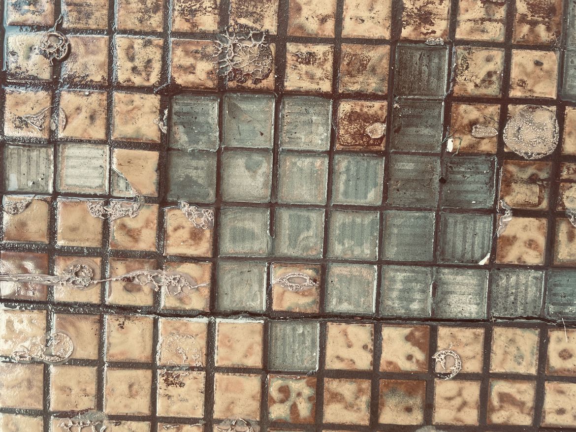

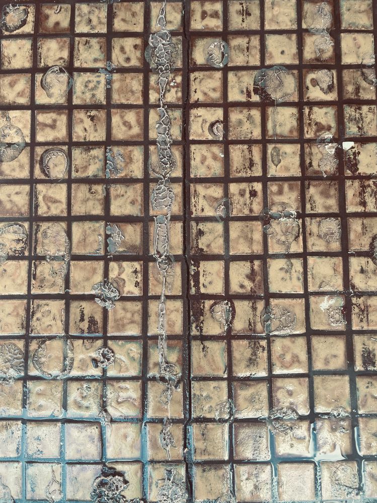

Hi Mitchell,

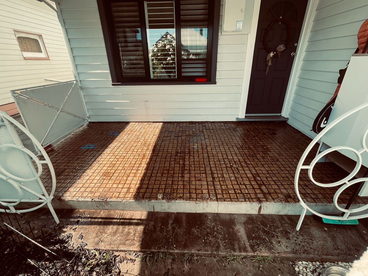

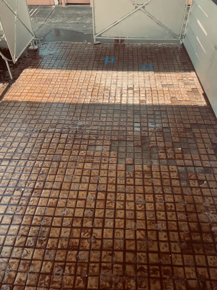

So I have pulled the decking out and exposed the tiles. They were all very stuck down, so a lot of residue on the tiles, but also a fair few tiles got pulled out in the process. By the looks of it too, it is fair uneven. Bunch of photos attached.
I am wondering if it is now best to completely remove the tiles, going to be an uneven surface to lay the joists I think? I could probably get hold of a jackhammer to remove them. I will need some advice on what to do next though to prep the concrete.
