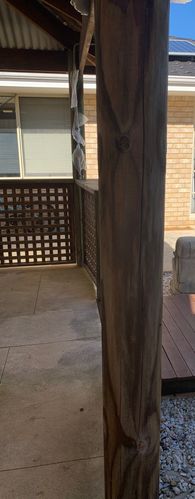

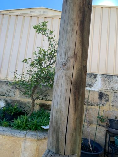

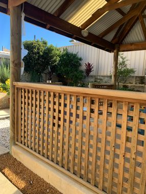

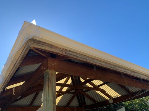

Here are some pics of the pergola and the checks in the pillar. Upon closer look some run quite long and some fairly deep so I'm not sure if that would be of structural concern. If its just cosmetic aspect
Also just want to check whether the woods under cover are the same type as the rest of the pergola. I've only used deck cleaner to scrub down the ones exposed to the elements and the wood under cover was only washed down with a hose. I'm not sure if they are the same type of timber or different as the colours are quite different.
So is it sufficient to just use a broom to clean before staining even after some heavy rains?
Appreciate your time and patience.

Nice looking pergolla and its in decent condition as well :smile: Id like to say Welcome to the community :), definently a fun place to hang out and just take a wander through all the projects.
As nothing has been done to the timber for 15 years I dont think there will be any problems with having to clean anything again. The only bit that I noticed was that first photo of the post in your last batch of photos. If its green mould I would clean any that I find first. I would think cleaners should kill whatever is growing there, if its the old colour of the timber I wouldnt worry about it.
As to the splits in the timber, Another one I wouldnt worry about as timber ages it does split naturally. If its to a point it concerns you then you could support the area first and replace the post but thats a long way to go for a cosmetic repair.

As @Dave-1 has said, the structure looks very good for 15-year-olds. Nothing jumps out at me that would be a structural concern. If there are any sections where you can see horizontal splits, this is something to evaluate, but vertical splits along the grain are perfectly normal and not a point of concern. This happens naturally over time as the timber ages. The fault line opens up due to the changing moisture and the breathable nature of timber.
The frame of the roof structure, and the lattice are H3-treated pine. H3 treatment allows for external use, without direct contact between the timber and earth.
The posts for your pergola are similar to these H4 poles. These poles are H4 treated, meaning they can be used externally and in direct contact with the earth.
These are rough pine products that use CCA treatment. The copper in this treatment gives them a greenish tinge, which unfortunately means they are not great at accepting stains as the green colour is impregnated into the timber and can show through lighter stains.
My advice if you would like to go with a stain, is to clean the posts thoroughly to remove any obvious green from the surface and to use a dark stain such as EXTERIOR STAINS CETOL SIKKENS 4L HLSE WNUT 10 - Walnut, followed by a clear coat varnish such as Bondall 1L Satin Monocel Gold Marine Clear Timber Varnish. The darker-coloured stain will help to cover the green better than a light stain will.
Please note that CCA treatments are toxic, and you should take all preventative measures to ensure it does not become airborne and is inhaled. I don't advise sanding them back for this reason. Any cleaning should be done with the use of a mask and gloves to prevent any possibility of ingestion.
