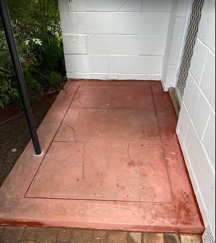

I'd like to paint our porch and have tried before using a latex exterior paint but after drying it was clear it hadn't adhered. I ended up peeling it of. The photo below is it's original state. I believe it's concete mixed with an oxide to give it that redish colour.
I want to ahieve a similiar colour if possible, hard wearing and not to slippery when it's wet.
How would I go about doing this?

I'd suggest you check out the Dulux Concrete & Paving range. It is a 3 step, tintable system that can give your concrete porch a new lease on life. It is stocked in Bunnings stores and can be tinted to whatever colour you wish from the Dulux range.
As it doesn't appear your concrete has a sealer on it, you would start with the Dulux 2L Concrete And Paving Bare Concrete Etch And Clean, followed by Dulux 4L Concrete and Paving Bare Concrete Primer.
Once prepared you would select your stage 3 product based on the colour and finish you would like to achieve. The helpful team at your local Bunnings will be happy to offer advice and assistance with selecting the right product for your specific needs.
You could also add Dulux 300G Concrete & Paving Anti Slip Additive to increase the slip rating of the surface to prevent a nasty fall.
Dulux Concrete & Paving has a wealth of knowledge you can use to select your products and information on the installation.

Glad it's possible for me to achieve as I had initially thought it would require some kind of sanding down of concrete using specialist equipment

No need for sanding in this case but it's important that you use all 3 stages of this system to ensure the best results.
