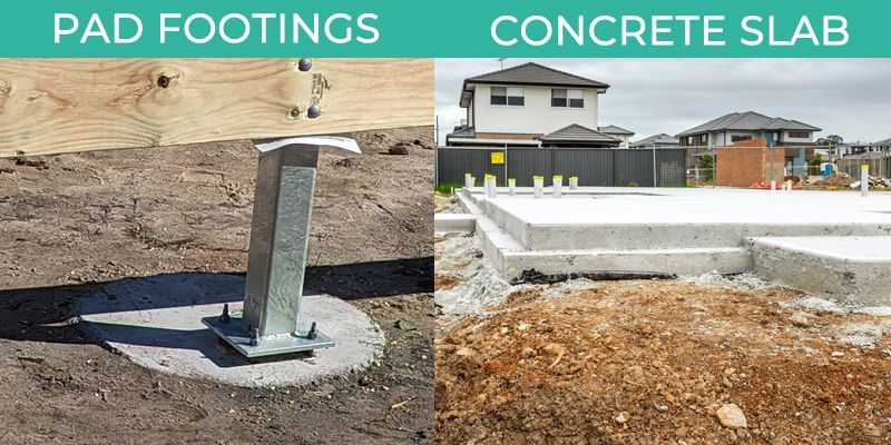

There are a few options when it comes to structural footings, you can use steel, wood or concrete. Where the footings will be placed depends largely on the size of the granny flat. The best person to answer this will be your builder or draughts person. If the tree roots are in the way of the footing the position of the granny flat will need to be changed.
If you are building the granny flat from scratch, then an engineering plan will need to be provided. Your engineer will calculate the optimal position for the footings. But if you purchase a granny flat kit, it will come with an engineering plan and the position of the footings will be pre-determined.
I imagine that you have a very particular place in mind for the granny flat, but I suggest having a second and third position handy just in case your first choice is not accepted.
