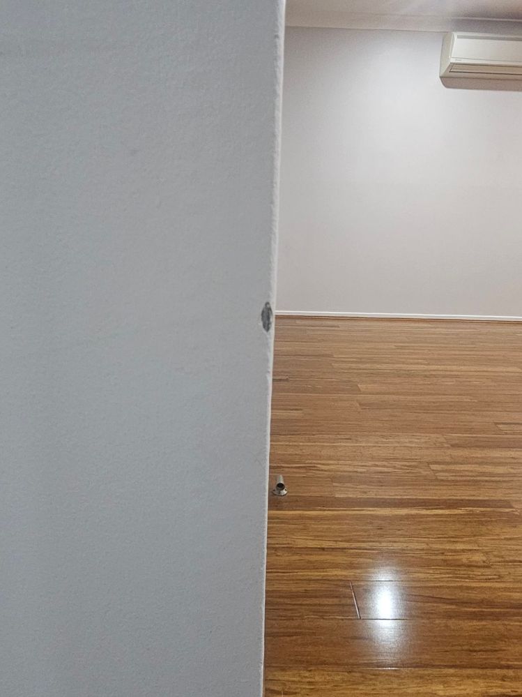

Hello,
We've just purchased our first home and have a few wall corners that have some small chunks missing (pictured - sorry for the bad photo). As we want to paint the house ourselves, what product can I use to fix damage like the one shown to the corners of my walls? There are also other dents and minor repairs needed to the walls - is there one product that could be recommended for me to use to fix the damage shown as well as regular dents in the walls before painting? I've gone down a rabbit hole of products and now feel overwhelmed.

Assuming all of the scrapes and dents are superficial, you can use a topping compound such as Gyprock CSR 2.25kg Less Mess Topping Compound for the repairs.
I would also suggest you purchase a good quality metal joint knife such as this Hyde 4" Plasterboard Joint Knife as well as a Trojan 120 Grit Angled Sanding Sponge.
The process to repair this particular dent would start with lightly sanding the chip down to remove any sharp edges, applying a thin coat of the topping compound, allowing it to dry and then sanding smooth with the sponge.
