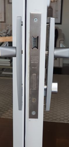

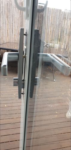

Hi Eric, Thanks for your suggestion.  However when I went to remove the plate you suggested to remove, which is on the internal side of the door, I couldn't because the lock/latch that you turn to lock the door  prevents you from removing it - it keeps it in place.  I can only move that plate a few mils out, as you can see from the photo.  The external plate comes completely off though.  Thats the one I screwed the screws into to make sure they screwed in ok whilst not on the door.  On the external side I can see the screws poking through, and try to centre them but as soon as I put that plate back on they lose their position as there's nothing to support them.  I can't help but think there's an easy solution but I just can't work it out.  Thanks for that suggestion though:)

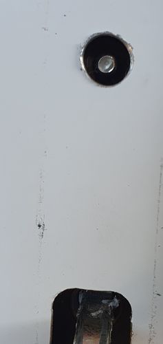

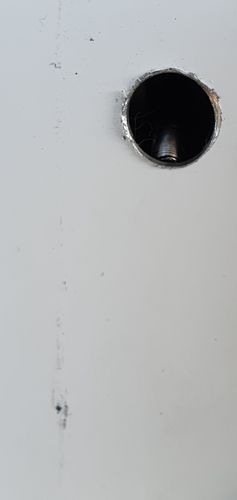

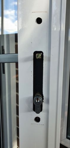

Hi Eric, Thank you once again for that suggestion.  I have been trying to fix this door since 9 am this morning.  A couple of times I've managed to get one screw in.  Now, I can't seem to even manage  that.  I have tried looking through the hole with a torch but it's still too dark to see.  It's crazy how loose this screw sits inside.  I know it keeps moving as I put the door handle on even though I'm holding in place with a screwdriver.  I've attached 2 pics of when I'm trying to centre the screw with a screwdriver and another pic when I remove the screwdriver just as an indication of how much the screw moves.
