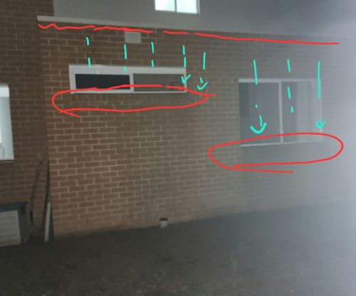

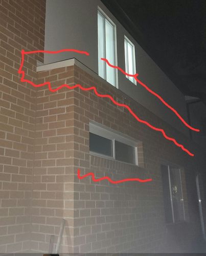

The absence of gutters on the metal roof causes water to pour directly down the walls, splashing onto the brickwork beneath the window sills and causing discoloration and green deposits on the wall.
Is there a temporary protective measure, perhaps a cover or shield, that could be installed to redirect water away from the window sills until ? I'm open to suggestions for any effective interim solutions.

You might like to speak with your builder to find out whether drainage was to be installed for that portion of roof, or if there is, whether it is functioning correctly. That sounds like a bit of an odd situation where water would be allowed to cascade from a roof over and down a wall. I'm more thinking of long-term issues, like the solid being undermined, rather than the immediate ones.
Having lengths of Apron Flashing 2400mm 0.55mm BMT Colorbond steel Woodland Grey - Woodland Grey attached above the windows would likely create enough of an awning to prevent water landing on the window sill. However, if the water volume is significant, it's probably best to consider installing guttering along this wall.
